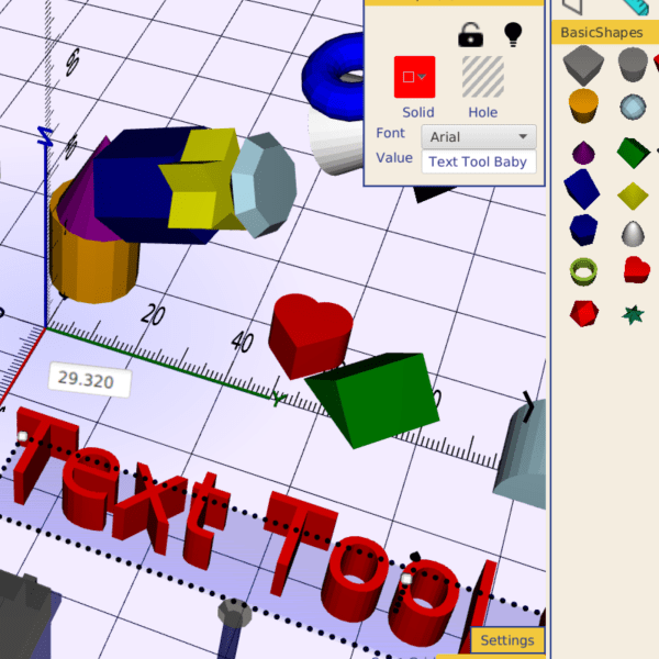

While we use a lot of CAD tools, many of us are fans of Tinkercad — especially for working with kids or just doing something quick. But many people dislike having to work across the Internet with their work stored on someone’s servers. We get it. So does [CommonWealthRobotics], which offers CaDoodle. It is nearly a total clone of Tinkercad but runs on Windows, Linux, Mac, or even Chrome OS.
Is it exactly Tinkercad? No, but that’s not always a bad thing. For example, CaDoodle can work with Blender, FreeCAD, OpenSCAD, and more. However, on the business end, it sure looks like the core functions of Tinkercad.
The program appears fairly new, so you have to make some allowances. For example, the Linux AppImage seems to have difficulty loading plugins (which it needs to import many of its file formats). In addition, on at least some systems, you have to resize the window after it starts, or it won’t respond. But, overall, it is pretty impressive. The Settings, by the way, has a checkbox for advanced features, and there are some other goodies there, too.

Hey there folks! I am the creator of CaDoodle and I am so happy people are hearing about it and using it! After the Tinkercad outage due to the AWS outage, I started noticing CaDoodle getting lots of attention.
I am always looking to improve this tool, and am especially looking for other Java devs to help out with the slowly growing back-log of issues. If you are interested in helping, or just using, CaDoodle, please consider joining our discord through the link on the main page.
Feel free to AMA :)
