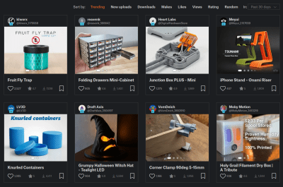

One little-spoken aspect of 3D printing is how few models are open-source. Printable models published exclusively as STLs are commonplace, STEPs are much less popular, and from my experience, it’s soul-crushingly rare to see a source file attached to a model on Printables. I struggle to say that’s a good thing, and quite obviously, that negatively impacts 3D printing culture – getting into 3D modeling is that much harder if you can’t reference the sources for 95% of models you might get inspired by.
Of course, part of that is that 3D CADs are overwhelmingly closed-source paid software, and there are like five different ones with roughly equal shares of usage. It’s hard to meaningfully share sources from within a paywalled siloized market. Also, unlike software source code, STLs are very much cross-platform. Electronics has a way better analogy for STLs, they’re just like gerbers – gerbers are easy to export, and to inexperienced people, they’ll feel like all that anyone would ever need.
For a quick example – out of these eight Printables models taken at random, only the “drawers mini-cabinet” has a source file attached.
Then, there’s a self-consciousness and perfectionism. While rare, I’ve seen “I will clean this up and publish later” happen in 3D printing spaces too – it’s a thoroughly non-viable promise there too, but I get why people say that, I’ve personally made and failed on such promises a good few times myself. I’m glad that this isn’t a popular excuse so far, but, as more people adopt OpenSCAD, Blender, and FreeCAD, with their universally-accessible files, maybe we’ll see it resurface.
Asking for 3D model sources should probably become part of hacker culture, just like it helped with software. I don’t think it’s great that 3D printing so often implies closed-source 3D models, and undoubtedly that has limited the growth of 3D modeling as a hobby. I strongly wish I could git clone the 3D model projects I find online, and there’s a whole lot of models that are useless to me because I can’t git clone and modify them.

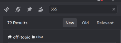

Discord blows as a platform, and I’ve written a fair bit about just how much it blows. One such snippet is in the article I wrote about the Beepy project, where the Discord server was crucial to growing Beepy as a community-contributed project. Would people benefit from the Beepy project having publicly available logs? Most certainly, and I’d argue it’s hurt the Beepy project being more externally discoverable. Is that all?
Discord has been an unprecedented communications platform for the Beepy project, and we’d outright lose out if there weren’t hardware hacking communities thriving on Discord, like Hackaday Discord does. I think we should remedy these kinds of problems by building helper tools and arguing for better cultural norms, just like we did with software licenses, because giving up on platforms like Discord currently has a significantly subpar cost-benefit analysis.
