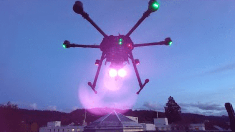

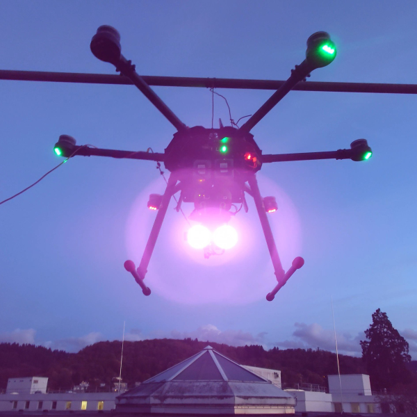

Tagging wildlife is never straightforward in the best of times, but it becomes a great deal more complicated when you’re trying to track flying insects. Instead of trying to use a sensor package, [DeepSOIC] attached tiny, light retroreflectors to bees and hornets, then used a pulsed infrared light mounted on a drone to illuminate them. Two infrared cameras on the drone track the bright dot that indicates the insect, letting the drone follow it. To get a spot bright enough to track in full sunlight, though, [DeepSOIC] had to drive some infrared LEDs well above their rated tolerances.
The LEDs manage to survive because they only fire in 15-µs pulses at 100 Hz, in synchrony with the frame rate of the cameras, rather like some welding cameras. The driver circuit is very simple, just a MOSFET switch driven by an external pulse source, a capacitor to steady the supply voltage, and a current-limiting resistor doing so little limiting that it could probably be removed. LEDs can indeed survive high-current pulses, so this might not really seem like component abuse, but the 5-6 amps used here are well beyond the rated pulse current of 3 amps for the original SFH4715AS LEDs. After proving the concept, [DeepSOIC] switched to 940 nm LEDs, which provide more contrast because the atmosphere absorbs more sunlight around this wavelength. These new LEDs were rated for 5A, so they weren’t being driven so far out of spec, but in tests they did survive current up to 10A.

    1. leds are on only when cameras are exposing.
      We did consider subtracting the dark frame, but because this background is moving fast when cameras are panning fast, it is a bit trickier/less effective than it may seem (still probably possible, as we have all the info on how the camera is moving).
      As for compute power, our current onboard computer is almost maxed out, but it’s all happening on the cpu, so there is actually quite a lot of potential to unlock here.

    3. Unfortunately, just increasing the number of leds requires more space (mostly because of collimating reflectorlenses), which in turn makes the gimbal heavier, which in turn requires bigger motors and sturdier mechanical parts, ending up with either a heavier drone that will have like half the flight time, or an even bigger drone instead (this one is already unreasonably big). LEDs themselves are a relatively cheap part of the project (~60 eur total), so gambling on them is totally justified. And none have even actually failed so far.

    2, 50 us, not 15. I know i said 15 in the video by accident. Not thatit matters very much, though
