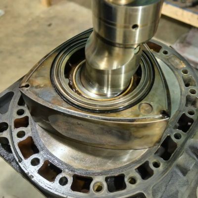

The eccentric shaft and rotor of the Mazda 12A rotary engine. (Credit: Baked Beans Garage, YouTube)

Yet even 1980 versions were not without issues, a case in point is the Mazda 1st gen RX7 with a 12A rotary engine that the [Baked Beans Garage] over at YouTube got their paws on. Starting with unsuccessful attempts to make the car start, the next step was to roll the car into the morgue garage for a full teardown of the clearly deceased engine.
About 35 minutes into the video, we get to the teardown of the engine, with its parts contrasted with those of a newer revision rotary engines alongside illustrations of their functioning, making it as much an autopsy as a detailed introduction to these rotary engines. Technically, they also aren’t the original DKM-style Wankel engines, but a KKM-style engine, as designed by [Hanns-Dieter Paschke]. [Wankel] didn’t like the eccentric KKM design, as he thought it’d put too much stress on the apex seals, but ultimately the more economical KKM design was further developed.
During the autopsy of the 12A revision Mazda engine, it becomes clear that it was likely overheating that killed the engine over the course of years of abuse, along with ‘chatter’ marks of the apex seals destroying the inner chrome coating. This would have compromised compression and with it any chance of the engine running, not unlike a piston engine with badly scored cylinder walls after ingesting some metal chunks.
