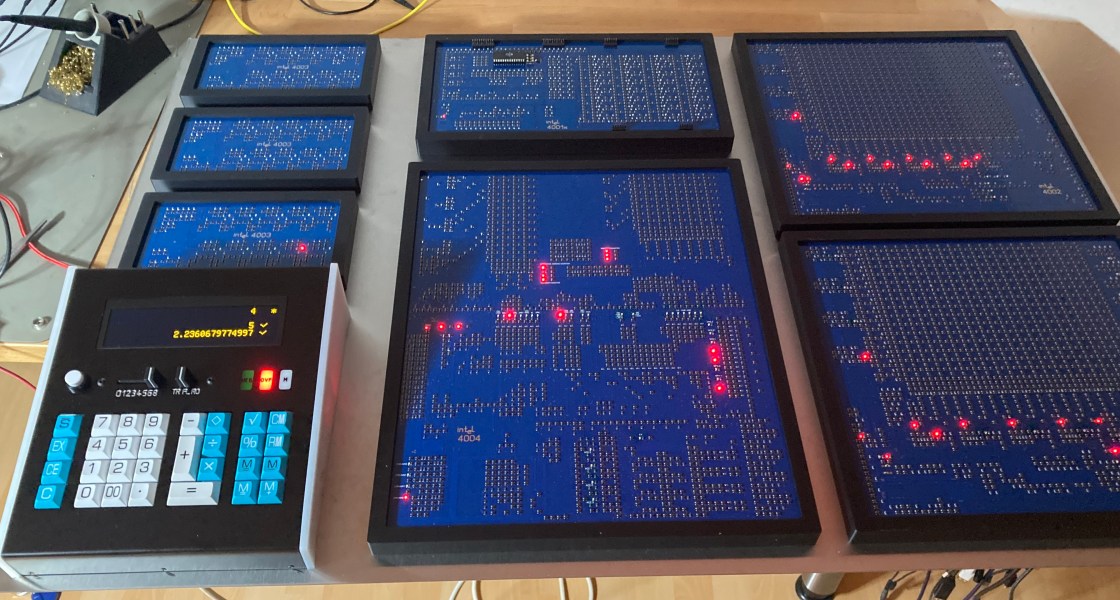

Though mobile devices and Apple Silicon have seen ARM-64 explode across the world, there’s still decent odds you’re reading this on a device with an x86 processor — the direct descendant of the world’s first civilian microprocessor, the Intel 4004. The 4004 wasn’t much good on its own, however, which is why [Klaus Scheffler] and [Lajos Kintli] have produced super-sized discrete chips of the 4001 ROM, 4002 RAM, and 4003 shift register to replicate a 1970s calculator at 10x the size and double the speed, all in time for the 4004’s 50th anniversary.
We featured this project a couple of years back, when it was just a lonely microprocessor. Adding the other MSC-4 series chips enabled the pair to faithfully reproduce the logic of a Busicom 141-PF calculator, the very first to market with Intel’s now-legendary microprocessor. Indeed, this calculator is the raison d’etre for the 4004: Busicom commissioned the whole Micro-Computer System 4-bit (MCS-4) set of chips specifically for this calculator. Only later, once they realized what they had made, did Intel buy the rights back from the Japanese calculator company, and the rest, as they say, is history.
Since its history, it belongs in a museum– and that’s where this giant, FET-based calculator is going. If you happen to be in Solothurn, Switzerland, you’ll be able to see it at a new history of technology exhibit opening at the Enter Museum in 2026. Do check out the write-up and links at 4004.com if you want to learn about this important piece of human history.
The museum-quality hack. Three 4003 shift registers are on the left, with a 4001 ROM above the 4004 CPU in the center, flanked by three 4002 RAM “chips” on the right. Photo by [Klaus Scheffler].

    1. Well, we only replaced the ROM transistor array with an programmable EEPROM, the remaining parts such as I/O etc are unchanged. To build a ROM out of transistors hardwired to a certain program code is possible, but very unflexible. So I wouldnt call it a cheat
    2. I supported Scheffler’s practical decision to prototype his first “discrete transistor” 4001 ROM using a flexible EEPROM. The original Busicom calculator accommodated either four or five 256×8 ROMs (allowing for an optional square-root function). This many “100% authentic,” giant 4001 replicas would have required customized pick-and-place scripts for ~4,000 additional transistors, providing little benefit other than “authenticity.” For flexibility, cost, and space savings, the upcoming Enter Museum exhibit will use a single ROM “chip” (PCB) for code storage and I/O logic. The team did debate whether to design a 4001 PCB faithful to Kintli’s reverse-engineered schematics. In the end Scheffler prototyped his “4001x” using discrete transistors only for bus and I/0 logic, the mask programmable ROM array replaced with an EEPROM. I think this was a good compromise.

  4. I had a hard time reading and counting the “chips” mentioned in the caption about midway throught the article.
    The source material says:
    Photo Legend: Center bottom: 4004 CPU. Center top: 4001 ROM. Upper left: Three 4003 shift registers. Right: Two 4002 RAMs. Lower left: Interactive Busicom 141-PF calculator user-interface replica.
    Note: two 4002 RAMs.
    Hackaday caption:
    Note: three 4002 RAM “chips”
    I also only count two on the right side.
    1. You are right. It is just a typo in the Hackaday article. I confirmed that the photo legend at 4004.com is accurate. The Busicom calculator firmware employs one 10-bit 4003 shift register to scan the keyboard matrix plus two 4003s (20 bits total) to control the line-printer’s hammers and black/red ink ribbon.
