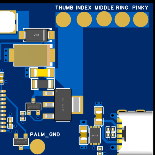

[Leon]’s TENS machine is specifically designed to help a relative with hand problems, so breaks out electrodes for each finger, with one on the palm serving as a common ground. This type of TENS is “monophasic”– that is, DC, which is easier than balancing current flowing in two directions through quivering flesh. The direct current is provided at 32 V to the digit electrodes, safely kept to a constant amperage with a transistor-based current limiting circuit. The common ground in the palm is pulsed at a rate set by an ATmega32U4 and thus controllable: 14 Hz is given as an example.

Without seeing the schematic or the code it’s hard to tell.
But it’s still mildly amusing/terrifying just seeing the layout. What happens when the victim touches USB ground with the other hand? What about electrode polarization from net DC? Is it low enough power density to avoid electroporation? What happens when that unprotected FET fails?

Its powered by a lipo battery, the usb port is only for charging it and i am sure should not be connected during use.
I too am sure it should not be connected during use, but there is nothing to prevent the user from doing just that. The first time, anyway.
Back when I worked at sparkfun I was obsessed with TENS unit laser tag and built some crude prototypes. Couldn’t get anyone else excited about it…
This is why some things are regulated. With no actual xformer to get true isolation all it’s gonna take is one of those caps to short one day to loose your isolation.
lose
Since this is only a single output TENS device, isolation is legally not required. An ESD event killing that bottom FET might be unpleasant though.
Oops, didn’t see this is powered by an externally accessible USB input. I assumed an internal battery like most TENS devices of this caliber.
it runs on a lipo battery, the usb port is for charging

It’s funny to read “I wrote firmware..” in a ChatGPT slop summary. Who wrote the firmware? An LLM probably had its virtual appendages in that as well.
And what’s that intended to say:
“A simple LDO wouldn’t cut it, because once the battery dips below 3.3V, the logic rail would collapse.”?
Had the author not chosen TPS55340 with internal 5A current limiting, an ATmega32U4 connected straight to VBAT would run just fine at 8 MHz across its 2.7-5.5V supply range, assuming BODLEVEL is set appropriately or disabled altogether. None of the components on the board look like a 100 µH inductor with a saturation current of 5A or more (you might be able to fit 1.5-3.3µH int what’s shown), so my guess is with the microcontroller connected straight to VBAT hammered with 5A load transients at power-up, it just glitched and restarted. That’s assuming this was even tried and we’re not just looking at made-up claims.
So we’re limiting the current? To what value? What does the application require and what are the mandated safe limits? For comic relief, let’s toss that prompt into ChatGPT, and lo and behold:
“IEC 60479-1 specifies the safe limits of current that humans can tolerate without serious harm. The standard provides the following general guidelines:
Threshold of perception: The lowest current that a human can feel, typically around 1 mA (milliampere) for AC and 5 mA for DC.
Let-go current (the point at which a person can no longer voluntarily release the electrical contact): For AC, this is around 10-20 mA, and for DC, it’s slightly higher at 50 mA.
Threshold of fibrillation (a potentially fatal situation): The standard suggests that currents above 30 mA (AC) or 50 mA (DC) can cause fatal effects, especially if sustained for more than a few seconds.”
So at 32 V, 10 mA (that’s 0.32 W output), where exactly do we need a DCDC converter with 5 A peak current? I’ sure LM2733XMF with 1A switch current limit and an equally small 10 µH inductor would have been just fine (datasheet lists a 30 V 110 mA configuration for starters).
But then again, that doesn’t provide proper isolation to protect against a dodgy USB adapter.
There’s a multitude of reinforced isolation DCDC products out there, so I’d like to conclude with an example:
WE PPTI (1209 form factor) 750343725 (1:3.9) + Ti SN6505B or SN6501 transformer driver with doubled output voltage provides low capacitive coupling and reinforced isolation. The output voltage can be tuned with a small primary-side SEPIC converter across 2.3-5.5V for ratiometric output. There still needs to be current limiting on the output, but it’s going to be a lot safer than relying on a bit of insulating tape in a low-cost USB-C charger block.

Don’t you rely on a bit of insulating tape of a USB charger every time when touching a conductive phone case or the metal shield of the cable?
To a degree, yes, which is why those are so bad on their own. But it’s much worse when you have electrodes connected to your skin because those usually give much lower resistance by design than a simple touch would – like the conductive gel on EKG electrodes. I didn’t see any details on electrodes used for this project so can’t say anything for sure about them, but definitely doesn’t inspire confidence.
TENS devices use conductive pads and gel to lower the skin’s resistance and spread the current over a larger area, so you don’t burn yourself. Putting the current through a small point contact would be painful.
That also makes the devices pretty dangerous if they aren’t properly isolated. Normal skin resistance is from several hundred Ohms to kilo-Ohms. The TENS pads lower that to 10-20 Ohms, which means you can get harmful currents going through you even from low voltage sources, such as 5 Volt USB.
