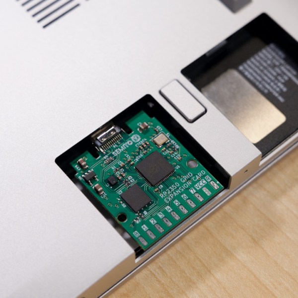

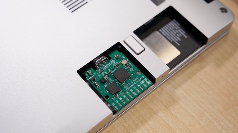

Ever want a microcontroller addon for your laptops? You could do worse than match one of the new and powerful microcontrollers on the block to one of the most addon-friendly laptops, in the way the Framework RP2350 laptop card does it. Plug it in, and you get a heap of USB-connected IO coming out of the side of your laptop – what’s not to love?
The card utilizes the Framework module board space to the fullest extent possible, leaving IO expansion on SMD pads you could marry to a male or female header, your choice. With about seventeen GPIOs, power, and ground, there’s really no limit on what you could add to the side connector – maybe it’d be a logic analyzer buffer, or a breadboard cable, or a flash chip reader, maybe, even an addon to turn it into a pirate version of a Bus Pirate? There’s a fair few RP2350 peripherals available on the side header GPIOs, so sky’s the limit.
Naturally, the card is fully open-source, and even has two versions with two different USB-C plug connectors, we guess, depending on which one is better liked by your PCBA process. Want one? Just send off the files! Last time we saw an addon adding GPIOs to your laptop, it was a Pi Zero put into the optical bay of a Thinkpad, also with an expansion header available on the side – pairing yet another legendary board with a legendary laptop.

  1. CC2 resistor is omitted, placement and routing of L1 and C1/3 is dubious (far away from the MCU, strange long leads to C4/6/7), C4/6/7 are not placed at the MCU pins where they should be. No via stitching leading to semi-islands of +3V3 and long current paths, also swiss cheese effect on GND on bottom layer leading to long current paths. Most zones do not have properly aligned edges (but that’s cosmetical issue). Stackup lists 4 layers, but 2 are unused in the drawing. There’s a net class /GND (inverted GND is probably SKY?). Given how RP2350 is easily subject to instabilities caused by the internal DC/DC, I would be skeptical of stability of this design.
    Outline of the PCB is not compatible with the official case model (too large, too thick)
    https://github.com/FrameworkComputer/ExpansionCards/tree/main/Mechanical
    1. CC2 resistor is not needed (and in fact would be a big problem for the card’s functioning afaict), since you only need one resistor when wiring to a USB-C plug, unless you also add an emarker to your board or emulate one through PD controller code (but then it’ll be Ra aka 1k). RP2350 dcdc routing should be done well, yeah the distance is a little dodgy, and agreed on all subsequent non-cosmetic points. Also, the official case model is a starting point/reference, no? Unless it claims compatibility with that model. It would be a perfect fit for the card in principle, yeah.

      2. “CC2 resistor is not needed”
        Wrong, both CC1 and CC2 need to be separately pulled down in order for most chargers to recognize the device and give it 5V power. The Framework laptop probably doesn’t care, but that’s still not an excuse to not adhere to the USB C spec. Funnily enough, early Raspberry Pi 4 boards were guilty of this too.

    3. Hi! Thank you for the honest review. I couldn’t fit C1/3/4/6/7 near to individual pins of the MCU because of the tight placement of components and I couldn’t rearrange everything from scratch because we needed to produce the design until Maker Faire Rome 2025. Design is actually 2 layers. 4 layers are created by kicad while I was designing, i don’t remember why. I deleted them manually before sending the design to NextPCB. Also for the template, NextPCB one is not fully compatible with the official case model due to slightly changed position of holes and different edges that are changed to fit manufacturing standards of the factory, but default Framework one should fit just right. The slight nearing of pads to the border is intentional to give direct open access to the pins.
      We have our own 3D case for the card designed by XenoCow: https://www.printables.com/model/1445941-framework-expansion-card-case-for-typec-950-arp24
      I have actually tested the board and clock frequency, memory acces, VCC, regular digital and ADC pins all seem to work pretty fine. The project is educational and is made as part of a student team called SemiTO-V. That being said I want to make a commercial (still fully open source) version outside of the team and will definitely take your considerations into account, especially better routing, implementing via stitching and avoiding swiss cheese!
