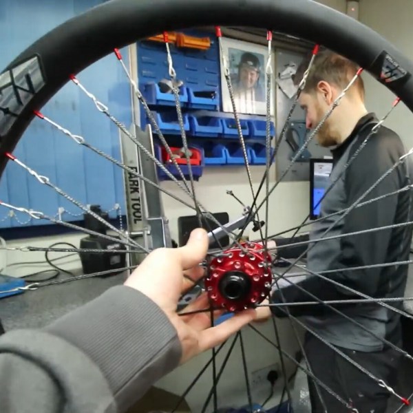

We know this one is a few years old, but unless you’re deep into the cycling scene, there’s a good chance this is the first time you’ve heard of [Ali Clarkson’s] foray into home made rope spokes.Â
The journey to home-made rope spoke begun all the way back in 2018, shortly after the company Berd introduced their very expensive rope spokes. Berd’s spokes are made of a hollow weaved ultrahigh molecular weight polyethylene (UHMWPE) rope with very low creep. They claim wheels stronger than steel spoke equivalents at a fraction of the weight. Naturally forum users asked themselves, “well why can’t we make our own?” As it turns out, there are a handful of problems with trying this at home.
There are a number of ways to skin this proverbial cat, but they all center around some very special nautical ropes, namely, Robline DM20. This rope has excellent wear and creep characteristics, in a hollow weave much like what Berd developed. The hubs also require the addition of a bevel around the spoke holes to prevent wear. Beyond those two similarities, there are quite a number of ways to lace the spokes between the hub and wheels.
As detailed by [Ali Clarkson], one method involves creating loops out of bike spokes, with a custom jig and some brazing. Then a length of rope is passed through the hub and a special hitch is used to keep it in place. Two loops are made in the ends of this length of rope and passed through the spoke ends made earlier. Finally everything is brought up to tension and trued much like a normal wheelset. The front wheel ended up weighing around 700g, a rather impressive feat for a 24 inch downhill wheel.
However, a number of other methods have been tried on the forum threads. Namely, a number of users have attempted to varying degrees of success putting a length of spoke inside the hollow rope weave and “Chinese finger trapping” it together. The key issue here is sourcing a glue strong enough to hold the spoke piece on at lower tensions, but flexible enough to not crack with the cyclical loading on a rim.

My big concern would be stress at the loops bends. HDPE looses a ton of strength at extreme bends. Those bends get extremely hot under load / stress weakening the material. I would be afraid of a cascading failure.
Having seen a carbon-fiber-spoke wheel explode into a mass of spoke-fiber fluff because of a single event, I think your concerns are well placed. Fortunately the guy was just getting on the road so he wasn’t hurt.
Would it work better if the cords were wrapped around the hub to reduce the bend radius?
I wonder if the weight reduction outweighs the increased air drag. Those certaily don’t make aero-shaped spokes.
You’re not going to find track bikes using these. They’re generally already at their low weight limit (6.8 kg), and air drag is important at 60 km/h.

The diameter wire used in the video seems quite thick. Thicker than the steel equivalent, at least. I’m a bit ignorant on bike construction and couldn’t easily find how much tension the standard spokes endure. Does someone here have the details, and can tell me why a wheel full of 100 kg rated (0.8 mm) won’t work?
Probably more about momentary forces, such as those experienced traversing terrain, than the steady load forces required to maintain structural integrity. I’ve seen super-slo-mo of a bike wheel going over an obstacle, and I can see why sometimes if the momentary load is too much, they “taco’.
A steel spoke is typically preloaded to 100 kgf. You’ll want a cross section sufficient for several times that.
Thank you. I’ve greatly underestimated the force on each spoke, let alone the whole hub.
Most of my builds are very low risk, and even if I break a cable, all I lose is time.
Materials for making archery bow strings are available relatively cheaply, Dyneema is at the lower end of the capability/price curve. Much like with bow strings, you may be able to control the length of the spoke (and hence the tension) by adding more twists.
Normally when wheel building spokes are tensioned to about 100kgf/1000N. This will drop slightly when the tyre is inflated, but when riding will vary substantially between carrying weight or being pushed into the ground.
You’d probably want to experiment on the back wheel first, where failure is frustrating rather than a trip to the hospital. Unfortunately the back wheel is where spoke tension demands are highest due to asymmetry due to the gears.
