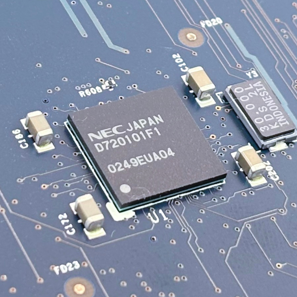

At various times in the history of desktop computing, the market has stubbornly refused to follow the path dictated for it by a dominant manufacturer. IBM’s move to MCA in their PS/2 line is one of many examples. Another is Apple’s take on USB a couple of decades ago, when their view of the future lay with Firewire 800. [Pierre Dandumont] has revisited a Power Mac G4 from that era and unleashed what Apple never did back in the day: a USB 2.0 port. (French language, Google Translate).
The hack lies in Apple shipping the machine with an NEC USB 2.0 controller, but only using it for USB 1.1. A PowerPC Linux distro will happily use it for USB 2.0, but Mac OS refused. Replacing the BIOS ROM with an image designed for the same Mac without Firewire 800 cured the problem, but at the expense of being so we’re told irreversible.
An obscure set of Macs from the early 2000s with an odd combination of hardware and OS may not count for much in 2026, but back in the day having USB 2.0 was a big deal and this would really have mattered. We like it that he put this together, even if the chances of having a G4 on the Hackaday desktop probably isn’t too high.

  3. As far as I now, Mac OS 8/9 sees a NEC USB 2.0 chip as USB 1.x but Mac OS X sees it as USB 2.0.
    A few years ago it wasn’t that uncommon in Mac community to add a compatible USB controller card to an older Macintosh.
