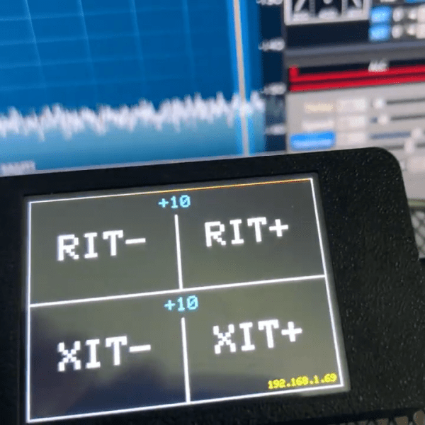

Stream decks are pretty useful in all kinds of contexts, but commercial models can feel a bit pricy for what is effectively a bunch of buttons. [WhiskeyTangoHotel] has whipped up one of their own on the cheap using some readily available parts.
The build came about due to the use of Stream Decks as a common way to control the Flex-6400 software-defined radio. [WhiskeyTangoHotel] figured that using a full-priced Elgato Stream Deck was overkill for this purpose, and that a cheaper interface could be put together for less. Enter the Cheap Yellow Display—a combination of the ESP32 microcontroller with a 2.8-inch touchscreen LCD. It was simple enough to code the device such that it had four big touch buttons to control RIT-, RIT+, XIT-, and XIT+ on the Flex-6400. Plus, with the ESP32 having WiFi onboard, it’s able to control the radio wirelessly—you just need to feed the unit 5 volts, and you’re up and running.
[WhiskeyTangoHotel] set this unit up specifically to control a radio, but you don’t have to feel limited in that regard. The ESP32 is flexible enough that you could have it control just about anything with a bit of different code. We’ve featured more flexible designs along these lines before! Video after the break.

  4. My bad, I see that the connection is WiFi and the ip address and adjustment value appear on the screen, seems quite useful. Still miss the physical clicks, but I believe a clear acrylic and some tact switches off the edge for them to activate would satisfy that.
