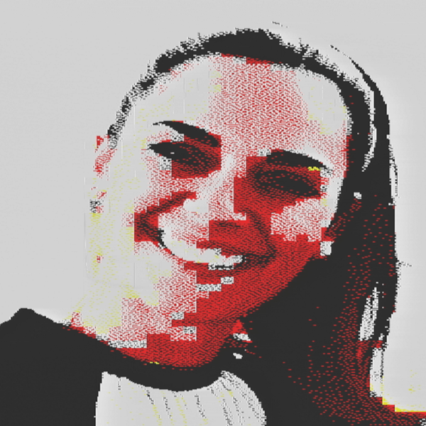

A PIC18F47K42 is perhaps not the first part you would reach for to pursue any sort of video-based project. However, with the right techniques, you can get the 8-bit microcontroller pumping out the pixels surprisingly well. [grecotron] was able to get the chip outputting to a VGA monitor at a resolution of 360 x 480 with up to 16 colors. It took some careful coding to ensure the chip could reliably meet the timing requirements for the standard and to get HSYNC, VSYNC, and the color signals all dancing in harmony. Aiding in this regard was that the chip was clocked with a 14.3182 MHz crystal to make it easy to divide down from all the internal timers as needed. Supporting hardware is light, too—primarily consisting of a VGA connector, a couple of multiplexers, and resistor ladder DACs for the color signals. Files are on Github for those interested in deeper detail on the work.

  2. Nice project. And with a very detailed project documentation! The image mode with the foreground and background color per 8×8 pixel cell is similar to how many 8-bit computers did high res color modes back in the day.

    1. Creating a stable VGA signal on an 8-bit mcu turned out to be the easy part.
      Pushing it all the way to a full 480 lines of vertical resolution… that took some real effort.
      Getting a real‑time interpreter to parse ESC commands over UART while rendering video on the fly… That was pure agony.
