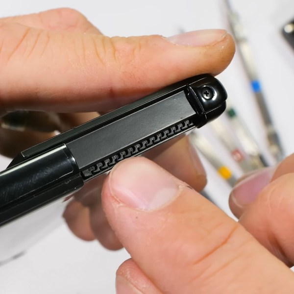

When LG left the smartphone market, quite a number of strange devices were left behind. While some, like the Wing, made it to consumers, others did not. The strangest of these would have to be their rollable phone concept; a device which would expand by unrolling a portion of the screen like a scroll. This never made it to market, but one managed to make its way to [JerryRigEverything’s] workbench, and we are fortunate enough to see the insides of this strange device.
There are a few interesting tidbits about the device before even entering the device. Very clearly this phone was ready to be sold, with a tidy user interface for expanding the display, and even animated wallpapers which expand with it. The display, when rolled onto the back of the device, sits behind a glass cover to keep it protected from debris, and can be used to take selfies with the larger sensors of the rear facing cameras. You can also see a bit of the track that the screen rolls on, hinting at what lies inside.
The “zipper-like” sliding sliding mechanism.
One doesn’t have to get far into a teardown of this phone to find more. A tiny brush hides in the curved corner of the screen rolling mechanism, to keep debris out of the pocket the screen sits inside. This also gives a better look at the aforementioned track system, which guides the display around the corner and keeps it stable and secure.
Further inside, you can see the mechanism which allow the phone to unfurl. Two rather small, but powerful DC motors resting a rack and pinion move the surprisingly strong phone to its full sized state. A number of spring loaded arms provide stability to the mechanism, preventing racking. The mechanism is surprisingly strong, able to push a number of books out of its way. However, if its movement is resisted, it will display a warning that you might damage the phone.
