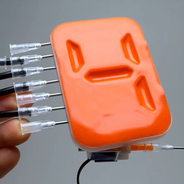

There’s a long history of devices originally used for communication being made into computers, with relay switching circuits, vacuum tubes, and transistors being some well-known examples. In a smaller way, pneumatic tubes likewise deserve a place on the list; [soiboi soft], for example, has used pneumatic systems to build actuators, logic systems, and displays, including this latching seven-segment display.
Each segment in the display is made of a cavity behind a silicone sheet; when a vacuum is applied, the front sheet is pulled into the cavity. A vacuum-controlled switch (much like a transistor, as we’ve covered before) connects to the cavity, so that each segment can be latched open or closed. Each segment has two control lines: one to pressurize or depressurize the cavity, and one to control the switch. The overall display has four seven-segment digits, with seven common data lines and four control lines, one for each digit.
The display is built in five layers: the front display membrane, a frame to clamp this in place, the chamber bodies, the membrane which forms the switches, and the control channels. The membranes were cast in silicone using 3D-printed molds, and the other parts were 3D-printed on a glass build plate to get a sufficiently smooth, leak-free surface. As it was, the display used a truly intimidating number of fasteners to ensure airtight connections between the different layers. [soiboi soft] used the display for a clock, so it sits at the front of a 3D-printed enclosure containing an Arduino, a small vacuum pump, and solenoid valves.
This capacity for latching and switching, combined with pneumatic actuators, raises the interesting possibility of purely air-powered robots. It’s even possible to 3D-print pneumatic channels by using a custom nozzle.

In theory, perhaps given a larger cell or a stiffer membrane, you should be able to use the vacuum within a cell to control a pneumatic transistor and with a read enable logic section, read off stored bits.

Quite a neat display, but I was still a bit disappointed when I saw the solenoids at 12:11. Somehow I expected that all the logic (counters, display decoders) was implemented with vacuum valves too. (Not the light bulb variant!)
Simple logic (and and or gates) are fairly common in pneumatics but because of their bulk and cost (compared to a PLC) it’s usually only used for very simple functions.
I do wonder if this can be miniaturized enough to be used as a practical braille display.

Now that’s interesting… What if the silicone sheet was translucent white and the bottom of the cavity was a bright color? Or maybe even just black? Would help visibility quite a bit, I imagine.
Good concept to build a Braille display.
