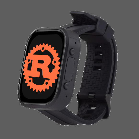

Waveshare makes a nifty little ESP32-S3 based smartwatch product, but its firmware is apparently not to everyone’s liking. Specifically, it’s not to [infiniton] a.k.a [Bright_Warning_8406]’s liking, as they rewrote the entire code base in Rust. No_std Rust, to be specific, but perhaps that doesn’t need to be specified when dealing with ESP32.
On the Reddit thread about the project, he lists some of the advantages. For one thing, the size of the binary has dropped from 1.2 MB to 579 kB while maintaining the same functionality. More interesting is that he’s been able to eliminate polling entirely: the firmware is purely event-driven. The CPU is not just idle but parked until a timer or GPIO event wakes it up. For this form factor, that’s a big deal — you can’t fit a very large battery in a watch, after all.
Getting drivers for the AMOLED display, touch sensor, audio, and RTC modules written from scratch is an impressive accomplishment. Apparently the screen driver in particular was “a nightmare” and we believe it. There’s a reason most people go for existing libraries for this stuff. [Bright_Warning] did not post screenshots or video, but claims his version of the watch watch can make HTTP calls to Smart Home, play MP3s, play the old phone games– Snake, 2048, Tetris, Flappy Bird, Maze– and even comes with a T9 keyboard for text input.
If you’re looking to get closer to bare metal, and don’t mind it being Rust-y, take a look at the code on GitHub in the first link above. This author isn’t enough of a rustacean to say if the code is as good as it sounds at a glance, but nothing egregious jumps out. The documentation describing exactly what’s going on under the hood isn’t half-bad, either. If you aren’t into Waveshare products, you could easily adapt this code into a more DIY ESP32 watch, too.

There is kinda this problem, author needs to actually make his mind on what this is licensed on
License
Source files under an open license (to be specified). Drivers inspired by Waveshare C code (BSD 2-clause) and esp-hal examples (MIT/Apache-2.0).
Hey, ty for the coverage! Really cool to see it featured here.
Quick update: license issue mentioned in the comments has been fixed the repo now ships with dual MIT/Apache-2.0 (the Rust ecosystem std). Thanks to vazhnov for flagging it, i forgot.
For anyone curious about the technical journey: yes, the CO5300 QSPI driver was indeed a nightmare. The chip requires minimum 2 pixel writes, quad mode data with single mode commands, and even aligned address windows, none of which is documented anywhere. Everything was reverse-engineered from the Arduino C++ sources.

One question, though: the RTC driver was “reverse engineered from Arduino code” even though a driver for PCF85063 has been avaialable on crates.io for two years now?
