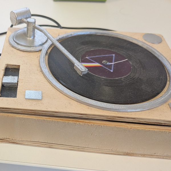

Streaming services have enabled many of us to have easy access to the world’s media library at the touch of a screen, but [Coconauts] thinks we’ve lost something along the way. To bring some intentionality back to the listening experience, they built an NFC record player called Minilos.
Like a normal record player, Minilos requires the user to select an album to play on the machine. These were originally decorative coasters with records printed on them, so they are much smaller than even a 45. Each one features an NFC tag that instructs ESP32 microcontroller hidden in the device to play the requested song. Once placed on the record player, it will then play through that album and come to a stop.
In [Coconauts]’s current setup, the ESP32 is connected to a Home Assistant server which then instructs a Google Speaker to play the requested song via Spotify, although we could easily imagine this being used to play music directly from an SD card or other digital storage device instead.

Given the turntable geometry (that looks like it was built by a cargo cult), does it play the music backward?
Of course! So you can hear those hidden reverse recorded lyrics.
