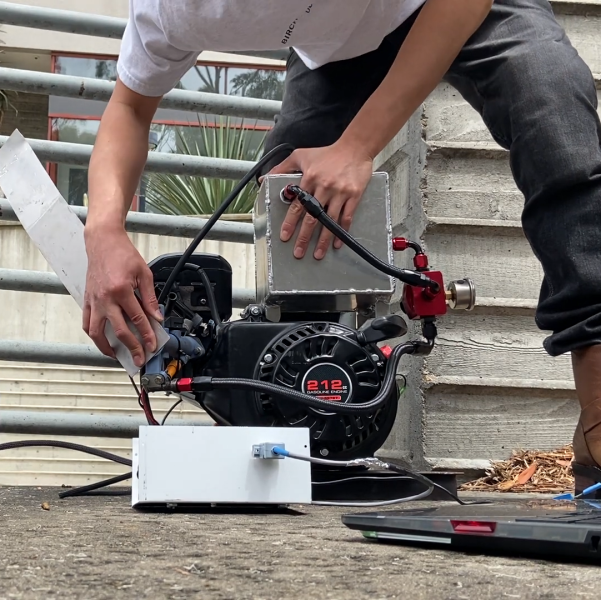

Small internal combustion engines usually keep things simple, relying on carburetors to handle metering the correct amount of fuel and air. Recently, [Carlos Takeshita] decided his small engine could use an upgrade in the form of electronic fuel injection (EFI).
The build began with a Predator 212, a popular gasoline engine from Harbor Freight. [Carlos] set about kitting it out with a missing tooth trigger wheel to measure the crankshaft position with a hall effect sensor. The engine also scored a custom-built aluminium fuel cell, complete with a high-pressure fuel pump and regulator suitable for driving the solitary fuel injector installed in the custom intake manifold. A Teensy 4.0 is charged with monitoring a manifold air pressure (MAP) sensor and the crank position, and choosing when and how long to fire the injector to dose the engine with the correct amount of fuel. Files are on GitHub for those eager to dive deeper.

What do you mean? It clearly has a feedback with the air flow?
I think they mean using an O2 sensor in the exhaust for closed loop control, as opposed to just using a MAP sensor monitoring input. (not even a MAF sensor)
FI without an O2 sensor works about as well as a carb w lots of extra complexity.

Impressive kit. Should add some bolts to hold it down next. Is there a butterfly valve in the intake or was the demo to show that it could run choked because of the control loop?
This project, the engine never sees any LOAD.
I’ve designed EFI for V-twin engines and it’s surprising how the cranshaft speed varies – slower on compression stroke and speeds up on power stroke. Pulsating air flow as well, make it very difficult to incorporate a MAF sensor. Speed-Density system is used as with many motorcycle engines, with O2 for cal.
