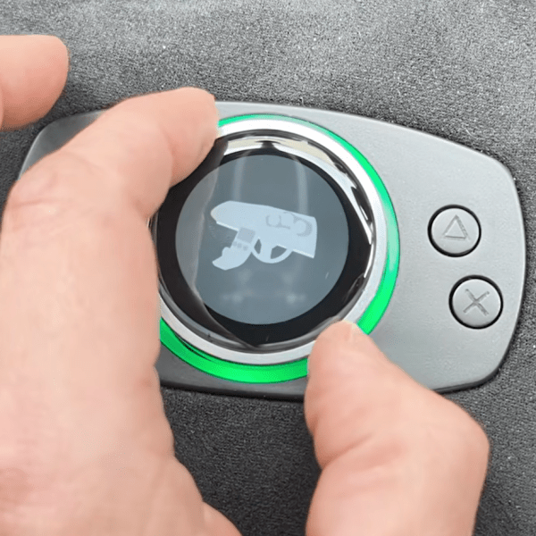

If you’ve ever spent time in a modern BMW, you’ve probably fussed about with the goofy iDrive controller. It’s a rotary knobbery slidery thing that just never really feels that good to use. [Garage Tinkering] was inspired to try and build a better version for his own car.
The first order of business was to choose the right knob as the core of the build. [Garage Tinkering] eventually landed on the Crowpanel 1.28″ rotary knob which integrates a push-button encoder, a round screen, and an ESP32-S3 all into one convenient package. He then set about designing a 3D printed housing that would integrate it into the vehicle’s interior, along with a diffuser ring for the knob’s inbuilt LEDs and some additional buttons for added control. The goal is to use the rotary control as the human interface for a broader system being implemented in the vehicle, which will feature a larger infotainment screen and multiple digital gauges. The rotary control will allow switching things like interior and underglow lighting, and display of other vehicle parameters.
