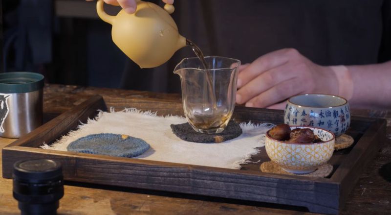

Pallets are a wonderful way to package goods and move them around, but especially the wooden ones have a very finite lifespan. This means that many of them are discarded every day, even though there is still good wood on them. Even if it’s not the highest quality wood, you can still use it for some nice wooden items, like the tea tray that [GR Woodworking] recently put together.
The reclaimed wood is the typical fast-growing, soft type, with the suspicion of it being paulownia here. Of course, wooden pallets use a wide variety of wood varieties, so not all reclaimed wood is equally suitable for applications like this, and identifying the type can be a challenge in itself.

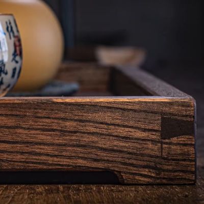

In the video it’s shown how the wood is planed to make it smooth and straight, before the joints are created and it is married to the poplar or aspen base plate. Of note is that absolutely no power tools or bulky things like router tables are used here, just basic hand tools that should make this kind of woodworking accessible to people even without that kitted-out woodworking shop.
After assembly it’s finished with Vararhana oil-based stain to give it a darker look and really bring out the grain. Naturally, since it’s a tea tray it has to be commissioned with a proper tea ceremony, which it passes with flying colors.

    He did nice work on the planing, was practiced enough to be able to saw a board lengthways (to reduce the thickness) leaving minimal marks, and his dovetail technique appeared good.
    But I’d have been happier if he’d spotted the gaps in the corners at the trial assembly stage, and fixed them.
