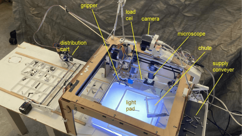

As someone who disassembles and repairs hardware, [Aad] eventually ended up with a huge collection of mixed bolts and screws. This led to creating the automatic bolt and screw sorting system you see here, although in a way it is just a proof of concept. Bolts and screws happen to be a useful application for now, but the system is capable of sorting just about any small objects.
Mixed pieces go onto a large conveyor belt, shown on the right. This feeds a few screws at a time down a chute, where they roll onto an illuminated platform.

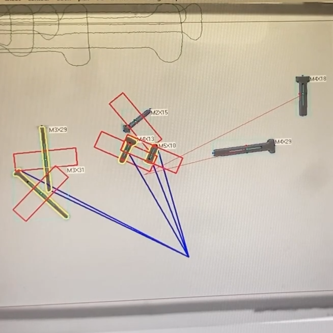

Above the lit platform is a camera, and machine vision is used to detect the size and shape and orientation of each screw. A robotic gripper on a gantry picks the screws up one by one — separating them first if they happened to clump together — and places each in a drop-off cart. The cart drops the object into a receptacle with its brethren, making sure similar ones are grouped together. Watch it in action in the video, embedded below the page break.
It’s a great build that shows fancy components aren’t necessary for good results. Servos and steppers are controlled with an ESP32-WROOM board, and a piezo sensor detects screws falling off the conveyor. Some of you may have noticed a repurposed Ultimaker 3D printer serving as the bulk of the system, its hot end having been replaced with a gripper that can raise and lower. The overhead camera is an ESP32-CAM adapted to accept M12 lenses so it can focus on the platform.
There’s one more feature worth mentioning — the system also has the ability to measure the weight of a picked object by placing it onto a moveable inspection platform, which can optionally put it under a USB microscope for a closer look. Everything is controlled by a nearby PC, so there’s a lot of flexibility built into the system.

I’m. Interested in the method used for part outline, I’m building a patterning system with vision that needs a reliable outline
“Contour Detection” will get you there.
https://www.youtube.com/watch?v=FKIn_UIsXy4 Contour Detection using OpenCV: A Comprehensive Guide

Hmm, no mention of sorting metric or asme threads which it might be sensitive enough to do
Yeah, good luck distinguishing between M5 and 10-32 threads. possible but unlikely with this setup.

Here in Europe we see very few non metric screws. Maybe it is possible to check the threads when I add a telelens. Magnetic grippers do not work on atainless steel
Hi Aad. To detect pitch you first need a high resolution image of the contour. Then in the threaded region of the contour do a FFT and then detect the peak of the FFT, excluding the DC offset. That’s a pitch measurement which combined with other attributes like the head diameter (e.g. metric and imperial socket head cap screws have different head diameters) can relatively accurately distinguish between e.g. a 10-32 and M5 which would otherwise be difficult to tell with pitch and diameter measurements alone. Treat each physical attribute measurement a orthogonal measurement ( an N-dimensional coordinate space) and best fit is traditionally the one where the cosine angle is the smallest between a known coordinate and the measured.
