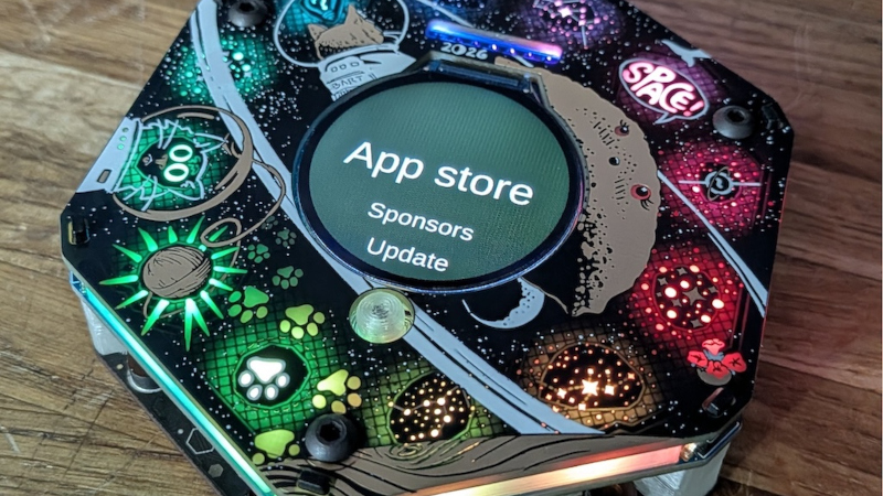

Two years ago the EMF hacker camp in the UK released a new kind of event badge. The Tildagon was designed to be a recurring event badge, useful for the next EMF rather than destined to be e-waste. With the 2026 event coming up there’s a new Tildagon called the Spaceagon, and as you might expect it’s very familiar indeed.
Tildagon owners can update their badge with the Spaceagon front panel (Update — The EMF badge team would like us to inform you that the final badge art will differ from the prototype badge shown), while those without one can buy the new badge. It has a few minor updates from its predecessor, including better buttons, LEDs, and display mounting, and there’s a compass, a joystick, and touch sensitive areas.
The Tildagon introduced its own add-on format, the Hexpansion. This year there’s the first official Hexpansion, a keyboard, using the same rubber moulding we see on quite a few maker projects. We like the Hexpansion idea because it uses an edge connector rather than a set of pins on the device, but at the cost of more expensive badge parts.
If you’re going to EMF you should be able to order yourself a Spaceagon, or an upgrade kit if you already own a Tildagon. Meanwhile we covered the 2024 version back when it arrived, and surprisingly this isn’t the first keyboard add-on for it either.

  3. It’s probably worth emphasising that this is a preproduction prototype with joke art. The actual 2026 badges will have different artwork on them, but that’s not revealed until camp.
    The EMF badge team do this every time, the website at https://tildagon.badge.emfcamp.org/ has last year’s final badge at the top, and the joke prototype below. If it’s got cats all over the front, it’s a prototype.
