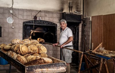

A baker stands next to the opening of his oven, a fresh loaf of bread on his paddle. In the foreground is a stack of loaves.
We all want our bread to come from a bakery like this one in Malta. Noport, CC BY-SA 4.0.
Advertising for bread is steeped in a tradition both real and imaginary, but behind the image does lie an artisan past. Very few English villages did not have a mill or a baker, whether the stone grinding wheels were driven by water or wind. The bread would have been made in much the same way as you’d make it in your 21st century kitchen, with the flour being mixed with water to a dough, before being slowly proved and leavened using a yeast culture, and baked. The oven would have been a wood-fired domed clay or brick affair rather than a gas or electric device, and perhaps our artisan baker of yore wouldn’t have used a neat rectangular tin, but the final product would be something you’d recognise.
You can still buy artisan bread made this way and it’s a fine product, but despite the industry leaning heavily on such imagery the loaf in your supermarket is not quite the same. This is not a judgement on its quality but a statement on the technological advancement that has given us an affordable, consistent, and often high quality mass produced product.

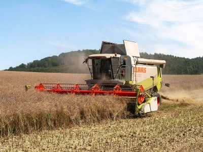

A green and white Claas combine harvester at work.
These things are the symphony of my summer. Reinhold Möller, CC BY-SA 4.0.
So to start with 21st century bread making, we need to stand in an Oxfordshire field like the one surrounding where I grew up. It’s the end of July, so the wheat is being harvested. The field will be part of a crop rotation scheme, so it may have had canola, beans, or any of a number of other crops grown in it the previous year. The wheat may be so-called hard wheat, usually a winter wheat with a high gluten content planted last autumn, or depending on the bread process it can be a spring-planted variety with a lower gluten content.
The wheat will be stored by the farmer in a silo until the best price can be had for it, then once sold it goes to a mill. A modern industrial mill rather than the rustic watermill of our previous description, but the principle is the same. The grain may be moistened to aid the separation of its outer husk, and then it’s passed through sets of rollers to grind it. This results in a flour, but it’s not the flour you buy, nor is it the flour that goes into your bread.

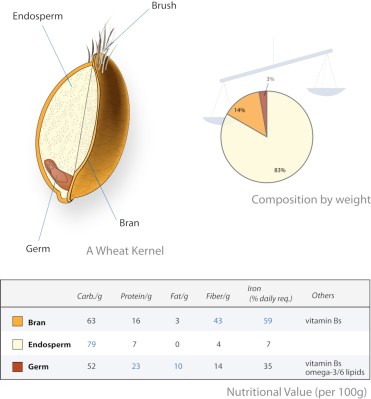

A cross section of a wheat seed, with nutritional information.
A wheat seed, in fine detail. Jon C, CC BY-SA 3.0.
A single piece of grain, a wheat seed, is loosely comprised of three components. The endosperm is the white flour portion you may recognise, the wheatgerm is the embryo, the part of the grain which germinates, and the outer husk is referred to as bran. The raw flour is wholewheat flour and you can bake with it, but it has the problem of a limited shelf life as the wheatgerm will spoil after milling if left. This the three components are separated, and the wheatgerm is heat treated to render it inert. The flour used for baking bread is thus compounded from these components to the formulation required, along with a set of additives to preserve it, improve its baking qualities, or add vitamins and nutrients. For a flour to be referred to as wholemeal its proportions of these components are defined by law, at least where this is being written.

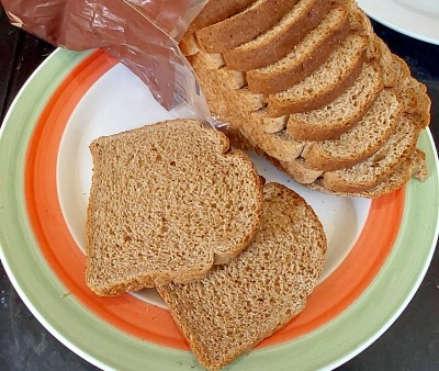

A loaf od sliced brown bread, cascading from its bag onto a plate.
The Chorleywood loaf in the kitchen chez List as this is being written.
The more mundane loaves in your supermarket though, are not made in quite the same way. They take flour and yeast and make a leavened dough just as with a traditional loaf, but the process is very different indeed. The Chorleywood process, named after the town hosting the research institution where it was invented, is a high-speed baking process designed to use a wheat with a much lower gluten content than traditional bread. The problem facing the mid-20th-century researchers who created it was that the UK’s climate and agriculture isn’t suitable for growing the quantities of hard wheat its bread market demanded. Their innovation was to replace the leavening and proving of the traditional bakery with high-speed mechanical mixing, which since some of the gluten is broken down in the traditional fermentation, requires less gluten. The result is an extremely fast industrial process that produces an extremely consistent light and fluffy bread, and over the last three quarters of a century it has become the dominant loaf. It’s likely that wherever you are, a similar process tailored to your country is also responsible for most of your bread.
