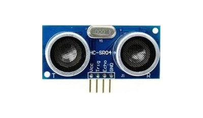

Second is the HC-SR04 ultrasonic distance sensor. Although fine for prototyping, it’s a 5 V module, lacks temperature compensation and other features that’d be needed outside a temperature-controlled room. Here ST’s VL53 Time-of-Flight sensors are a good alternative, containing a range of sensors of which we covered the fancier VL53L5CX previously for 3D scanning a room. Of course, you can also use reflective IR as a good cheap alternative.

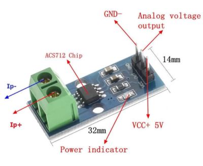

How not to use the ACS712 IC to sense mains current. Avoid this breakout board.

Seventh sensor and #1 on the list is the ACS712 current sensor. Specifically the mains-targeting breakout boards that are being sold everywhere. Here it’s not the IC that’s the problem, it’s that here – as also seen with various common relay boards – there has been no consideration given to basic mains power safety, such as creepage distance and general separation. The lesson here is that if you integrate mains power in your device, you do not skimp on safety with a sketchy module.

      6) HC-SR04 Ultrasonic Distance Sensor, use the VL53 ToF, a MaxBotix Ultrasonic sensor, or a IR sensor

      1) ACS712 Current Sensor, use the AMC1302, a current transformer, ACS37800, or certified energy metering module

  6. I can’t agree with him on the HC-SR04 ultrasonic modules.
    His first issue is that they are 5v parts, I rarely work at anything other than 5v.
    He mentions the accuracy, who is expecting precision with a sensor that works in air? I have been using these sensors for as long as they have been available, even started out with the polaroid transducers and they are great. I don’t need to know anything other than relative measurements for robotics. He mentions IR as an alternative, but this is affected by ambient IR and the colour of the object being measured.
    Add to that the expense of Maxbotics sensors and you can’t go past a sensor that costs $3.
    1. 5V in production designs is on its way out, though. If you need anything that has a bit of oomph (so STM32, ESP32, …) it’s gonna be a 3.3V part. AVRs and such are still 5V, but relatively expensive for what they provide. Secondly, the time-of-flight sensors like the VL53L5CX mentioned actually are great parts that don’t have the downside of the classic line-CCD-based distance sensors: they’re pretty resistant to both ambient light as well as color differences of the object measured.
      1. The CH32V0 microcontrollers can run from 5 volts. They are much cheaper and more powerful than AVRs.
        Many of the STM32 microcontrollers have some pins that are tolerant of 5 volt inputs.
      2. When speaking about processing and sensory applications. That is definitely a domain where 3.3V is the default rail. Especially since it is a very convenient voltage to power from stuff like batteries and somewhat easier to achieve efficiency with.
        But while great for that. 3.3 does tend to fall short of getting most FETs nice and saturated. With a lot of H-Bridge drivers, FETs and similiar (even newly designed) still really wanting that 4.5v minimum. Plus there are also just the sheer amount of busses that use 5V. Including the one that is connecting the very thing i’m typing on to my PC: USB. Making it the go-to for USB powered stuff.
        Which you encounter more often really depends on what you are doing. One could genuinely work almost exclusively with 5V and another with 3.3V.
        That aside. I indeed don’t see much reason to use that old kind of sonar sensor in this day and age.

  12. ACS712 current sensor. Specifically the mains-targeting breakout boards that are being sold everywhere. Here it’s not the IC that’s the problem
    I’m guessing that you did not read the data sheet. The 712 is rated for BI, at less than 300Vrms operational. This particular model is not intended to provide safe seperation and isoloation for human touch from mains voltage. But you are correct that most of these cheap boards make its use even more risky. That said, I’ve used the 712, and similar, for many years. Very simple and reliable. But my designs do not depend on the IC for protecting a human from mains voltage.
