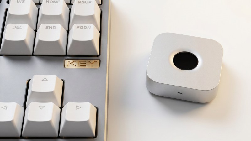

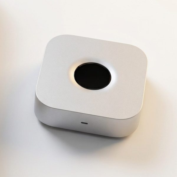

Once upon a time, there was a bit of a fad for fingerprint authentication in laptops and desktop computers. It has long since faded, but [superdog] wanted just such a device for Linux and Mac machines. Thus, it was time to build one.
[superdog] designed the device, nicknamed immurok, as a tool for people who use external keyboards, and do lots of terminal work on Mac and Linux machines. Repeat password requests can interrupt one’s flow when hustling at the keys, so immurok was designed to ease this pain.
The device is based on a WCH CH592F microcontroller, which comes with Bluetooth connectivity out of the box. This allows immurok to connect wirelessly to the machine of your choice, advertising itself as a standard Bluetooth HID keyboard device. Fingerprint-wise, scanning is done with an R559S capacitive sensor, which verifies the match locally so there’s no transmitting biometric data anywhere. On the computer side, Linux is setup to use a CLI/TUI app plus PAM integration to handle authorization for system logins and sudo in the terminal. On the Mac platform, it’s used with a menu bar app, with PAM integration for admin prompts. There’s also a separate helper path for using it with the lock screen.

The enclosure is beautiful, and i love the overall aesthetic.
Not really. In most of the cases, it uses secure data signature to verify itself and makes the authentication, including ssh, git, screen unlock on Linux. Only for mac screen unlock, it triggers a daemon app to send password to the screen unlock input. But the password is stored in you mac keychain instead of the device.
i am skeptical this works on mac though… most research for a mac finger print unlock leads back to decomposing a mac keyboard. unless this is like injecting the password…
Yup, because Macs store the biometric derived stuff in the Secure Enclave, and the reader just sends what it reads back to that.
This reads the fingerprint, decides if it’s a match, and then sends the password over BT. So it’s a device with your password stored in it… 😬
It uses PAM to do the authentication. No password is using on Linux and macos except the screen unlock scenario. And the password is stored in mac keychain, not in the device. You can read the secure model for more information https://immurok.com/blog/the-immurok-security-model/
