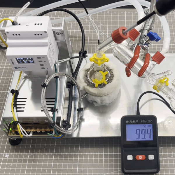

Much like radio operators being encouraged to use the least possible amount of power to make a contact, chemists have a similar rule encouraging using the least amount of materials in experiments. Not only is this rooted in economics, but in safety as well; if something goes wrong it’s generally good if there’s not excess amounts of reactants. With modern techniques, though, it’s possible to bring experimental chemistry down to incredibly small scales, and [Marb’s lab] found that they needed a custom built still for these new, diminutive experiments.

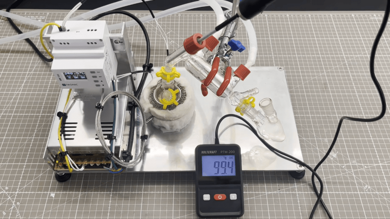

The first step is to build the heating component of the still. This is provided with a few custom aluminum parts for the base and a pair of heaters originally meant for 3D printers, with the assembled unit wrapped in insulation. The heater accomodates a 25 mL round-bottom flask. Temperature control of the heating mantle is provided by a controller mounted to a DIN rail which receives power from a 24V power supply, and an additional temperature probe is added to measure the temperature of the distillate. A test run with water shows the small still quickly and efficiently evaporating the water up to a condenser.

  2. Cool build. Only gripe I have is this isn’t microscale chemistry. This is more like benchscale on the small side. I’ve seen a lot of people do vacuum distillations on this scale, mostly with a short path condenser(usually those are shorter than this one but not by a ton).
    For microscale distillation you want to minimize the path length any condensate travels. There are special condensers you can use, I forget their names but they are intended to capture like 1mL in volume max. Usually small glass vials are used too, not flasks.
    1. There is no clear definition of microscale chemistry, but sure I could build an even smaller distill using just a test tube, a stopper with a bore and a piece of bend borosilicat glass tube.
