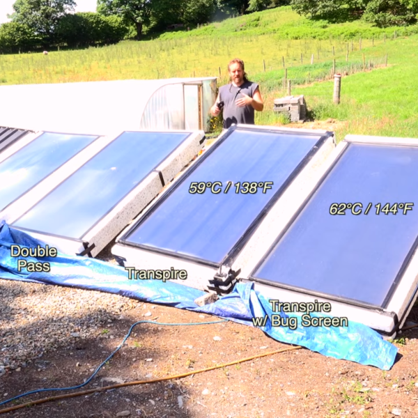

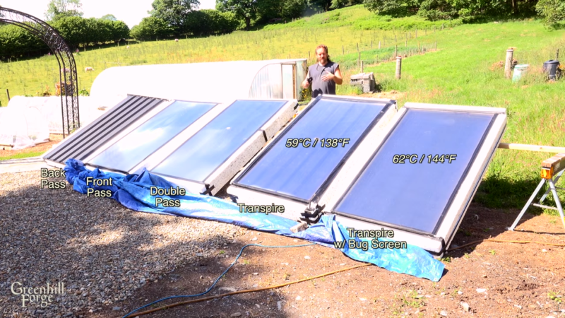

For as good as solar panels are at converting sunlight directly into usable electricity, especially for how cheap they’re becoming, they can still only gather around 20-30% of the energy that hits them. That’s fine if you have a large roof or a huge tract of land, but if you have limited space and need to do something like heat a home, there are better options available to capture more of that energy. [Greenhill Forge] has built five solar air heating panels to test this concept, and do it much more inexpensively than commercial options.
These solar heaters use sunlight to heat a fluid, in this case air, and move that heated fluid to another space. Each panel is about two square meters, insulated on all sides except the top, and configured in a way that air can flow past something that the sun has heated. The first panel, a control, does not use a glazing to help trap this heat, but the rest all have a polycarbonate window to increase the greenhouse effect of the panels. The four remaining all experiment with the way air flows around a black corrugated steel sheet to gather more of the heat, with the fifth panel using a set of black screen instead.
With the panels all set out in the sun, [Greenhill Forge] is using a set of thermocouples from a previous project to measure the efficiency of each panel. Surprisingly, he found that the panel using the layers of screen was the best at gathering energy, although he notes several times that these types of panels are extremely sensitive to changes in physical configuration, so this is not the most definitive test possible. However, at only around $100 per panel it’s quite a deal if the goal is a usable space heater that doesn’t use any fuel or grid electricity.

            In his own tests, he optimistically estimated that he collected 1400 watts in the sun, and when drying with this type of panel, of course if your temperature drops in clouds your useful efficiency can be zero despite still collecting some heat, though his remained at about 400 watts and a temperature that’s… well at least it’s mildly warm, not really useful for intense drying, but hey. We’ll see how much of that remains after a long set of ducts. I would point out that if you only want to dry clothes on a warm day, just put them on a line, don’t build a solar collector to provide mildly warm air to a machine or something.

  3. Alright: 22% efficiency* for the PV panels vs. 70-80% efficiency* for solar thermal panels sounds good. But it’s leaving out the whole chain beyond it. Heat transfer losses may amount to way more than your electrical losses if your heat source isn’t exactly where you need the heat. And if you have a need for heat in the warmer months you can use a heat pump which runs at about 500% that season of the year which will almost certainly get you more yield than the solar thermal approach. I get that this is cheap, simple, DIY and all. But the framing is missing the whole system aspect and quite frankly sounds quite ridiculous.

  5. I wonder if you could get the benefits of the peak heat provided by the bug screen transpire one but also make it less sensitive to cloud passover by adding the sheet metal for some thermal mass.
    Instead of painting the insulation black as he did with the bug screen one, lay a piece of the painted sheet metal down and put the vent through it as with the front pass one. Basically adding the two layers of bug screen for the transpire effect on top of the front pass design.
