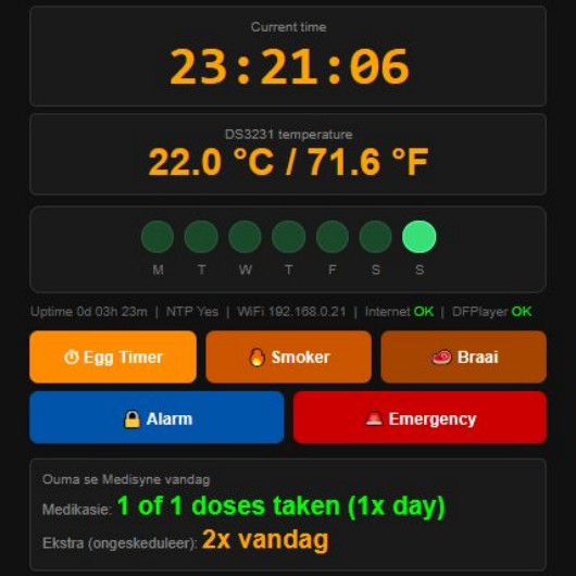

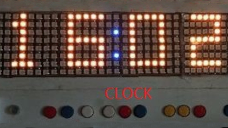

The clock was primarily intended to act as a useful tool for providing medication reminders, before some extra useful home functionality was folded in. The heart of the build is an ESP32-WROOM-32 hooked up to four 8×8 WS2812B addressable LED panels acting as a display. A further 30 WS2812Bs in a strip act as a status indicator. A DS3231 real-time-clock module ensures the clock keeps accurate time, while a BH1750 ambient light sensor makes sure the clock is responsive to current lighting conditions. There’s also a DFPlayer Mini audio module for spoken announcements and chimes, while there are inputs for AM312 passive infrared motion sensors that allow the clock to act as a rudimentary security monitor. There’s even a web interface for control and scheduling.
