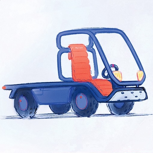

Cheap vehicles are thin on the ground in 2026, but [Andy Didorosi] thinks he has the answer for low-speed applications with an open source kei truck.
Still in the early design phase, [Didorosi] has an old factory in Detroit that has been home to his bus transportation business for the last several years, as well as the Sendpai kei truck project to make the world’s fastest kei truck. His vision is to make an affordable kit car truck that anyone can build in the comfort of their own garage. The current plan includes hub motors, which have so far not made it into any production EVs in the US, likely due to the problem with high unsprung weight.
While making a new vehicle from scratch is difficult, the project is targeting a modest set of capabilities at the beginning. The truck will be eschewing safety for low cost, which is probably fine for low-speed off-road use as a utility vehicle. Safety will of course get more important as speed increases. Once the design is sufficiently nailed down, [Didorosi] hopes to sell fully assembled trucks that are compliant with US Low Speed Vehicle (LSV) requirements. This would allow it on roads with posted speed limits below 35 mph. The kit version would be capable of highway speeds as it wouldn’t be required to meet safety regulations in most states.

  1. Hub motors have another problem besides unsprung weight: You’re asking a precisely assembled, high powered electric motor to absorb every pothole impact. Plus there’s the obvious question of where an open source car project is going to get a part that isn’t used on commercial applications and can’t readily be built at home.

        2. A trike needs to have its weight centered in the triangle formed by its wheels, which puts the ideal center of mass towards the two wheeled end. A tadpole truck would be very unstable when loaded, particularly if you didn’t put the bed entirely in front of the rear wheel.

    2. Hub motors are available for things like forklift trucks and other specialty vehicles, and factories in China will basically make you anything you ask just to keep a western company off the market. Souped up electric motorcycle hub motor stuffed into a car wheel rim? You got it. Found several in a minute of searching. EV conversion kits with hub motors all over the place.
      Whether these are truly viable for road vehicles is to be seen. Anything will work for a while, until it gets full of water and dirt, or overheats and burns a coil.
      The main challenge they’re trying to solve is getting rid of the axles and joints and differentials which would limit the geometry of the car and the suspension system, and would require more design effort than “a box on wheels”. That’s what everyone’s trying to do with hub motors, because it gives you the freedom over the form factor, and that’s where everyone fails because it turns out designing a car that handles and rides well, and doesn’t break, requires more than four wheels on a tube frame.
    3. The gator/ranger/side-by-side market is definitely a big part of what they’re targeting, and that’s mentioned later in the video. Most kei trucks imported into the US are used as small utility haulers for farm/ranch/local work already – unlike Japan, where they’re used for that and everything else a tiny truck can do.
      Re: hub motors, I’m also concerned that the cons outweigh the pros here, but it’s early enough in the design and prototyping process that I’d hope they could switch to a more conventional electric drive if it doesn’t work well in testing.
      Historically, there’s been another big problem with hub motors in four-wheeled vehicles; you’ve eliminated the synchronized control provided by the transmission and differential. This makes a lot of neat tricks possible, but it also converts a simple mechanical system into one that needs complicated computer control to run smoothly. Even getting two adjacent hub motors to run at the same speed when driving straight, rather than fighting each other slightly, is a challenge.
