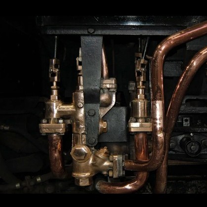

Here’s a historical hack for you: you have a big, rolling pressurized kettle, also known as a steam locomotive. It needs water to make up for the steam constantly chuff-chuff-chuffing away, or bad things happen. How do you get water from an unpressurized tender into a high pressure boiler with no moving parts? What you need is a some way to inject steam with no moving parts — a steam injector, if you will. [Marc Flint] found that the steam injectors were the hardest part of a loco to understand, so he made a video for all of us once he’d figured it out.
The steam injector isn’t a new idea. [Henri Giffard] came up with it back in the 1850s to replace expensive and maintenance-hungry pumps. It’s rather ingenious and uses the fluid mechanics uncovered by another European bloke by the name of Bernoulli. First, the high-pressure steam from the boiler goes through a converging-diverging nozzle to drop its pressure and speed its flow up, just as you’d guess if you’ve seen Bernoulli’s laws. Even more vacuum-inducing is the presence of water: the steam, already cooled by its expansion, hits the water in the pipe open to the tender, and condenses into it, shrinking a couple of orders of magnitude, creating a vacuum that draws in no small quantity of feed water. That one we did not expect from Bernoulli, but it makes sense. So how to get from below atmospheric pressure to the 180-odd PSI or more in the boiler?
Well, the water is now moving at a good clip, between the Venturi effect and the momentum gained from absorbing that steam, so another converging nozzle is the trick. Bernoulli’s law, once more! A one-way valve lets the now-pressurized water into the boiler, with a gap in between to dump water while the pressure builds up. It’s a clever trick, and since the steam coming from the boiler makes it back inside along with at least some of its heat energy, it’s much more efficient in both coal and water than running a pump. It’s also a bit of a head scratcher how it works unless someone sits you down to explain it, so we’re glad [Marc] did.

  2. Having spent a fair bit of my non-primary professional life working with high pressure steam devices (never advanced to a red-seal license, never needed it. Yet.) I still find injectors one of my favourite devices to operate and to service. They need a lot of service.
    THere are a large number of variants (lifting vs non-lifting, for example) that vary in the number of cones, feed configuration, checks and gaps, and ability to throttle water and steam flow automatically or manually. It can be a dance, especially when under varying loads.
    Turns out that injectors really only have great efficiency in applications like a locomotive, where the water is used single pass. In a closed or semi-closed plant (or any plant where waste heat from used steam or post-superheater flue gas can be recovered in feedwater) pumps win. In fact, though the heat from the steam used to power the feed is fully recovered, it is actually difficult to add additional preheat. Feedwater needs to be cool enough to fully condense the steam, and post-injector preheat using lost heat recovery generally is impractical, as the added piping drag reduces efficiency greatly.
    Still used as secondary/backup feeds on a lot of equipment in the real world, low and high pressure (up to maybe 20bar) as they are failsafe in theory. In practice, though, many operators can’t even get a Pemberthy with gravity feed to start and feed. That pesky maintainance and training thing…

        The feed steam need not be dry for an injector (though it is more efficient if it is) though shouldn’t, generally, have significant superheat. The feed water MUST be cool enough that ALL of the feed steam condenses to liquid in the combining cone for proper feed. There should be a solid, laminar(ish) stream leaving the combining cone, and in in designs with an automatic overflow check, the overflow chamber should be in vacuum to close it. Uncondensed steam will prevent the appropriate condition and feedwater and steam will be lost through the overflow gap, or the feed will break completely.
        This is why testing every shift and regular maintenance is a constant need: Cleaning (descale, remove debris brought in with feedwater, etc), clean and reseat check valves as needed (leaky feed checks will make it impossible to maintain water level and efficient fuel rate), clean the cones and make sure they are not eroded or steam cut, steam feed valve seats, seals and gaskets, moving parts move freely and say in the proper alignment, and so on.
