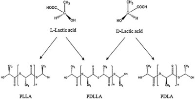

Although we use the generic acronym of ‘PLA’, there are actually two chiral forms of poly(lactic acid). Generally the one that we most commonly find in our spools of consumer-grade PLA filament is poly(L-lactide) (PLLA), while its more rare chiral form is poly(D-lactide) (PDLA). These match their chiral lactic acid forms, being L-lactic acid and D-lactic acid.
If both PLLA and PDLA are combined into a single polymer chain you thus get another type of material with its own set of properties. Overall this PDLLA polymer is quite stable, preferring to stay amorphous while still resisting hydrolysis better than its other polymer forms.
While industrial production of D-lactic acid is possible, most production is in the form of cheaper L-lactic acid, with correspondingly FDM printer filament thus having a high chance of being PLLA. This, along with factors like the ratio of crystallinity versus amorphous areas determines the initial state of the material.

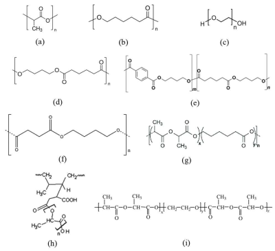

Plasticizing
Structural formulas of PLA (a), PCL (b), poly(ethylene glycol) (PEG) (c), PBA (d), PBAT (e), PBS (f), block copolymer of poly(L-lactide-co-ε-caprolactone) (PLA-PCL) (g), graft-copolymer of poly(lactic acid)-g-natural rubber (PLA-g-NR) (h) and triblock copolymer of poly(D-lactic acid-co-ethylene glycol-co-D-lactic acid) (PDLA-PEG-PDLA) (i) (via Mastalygina et al., 2024, Polymers)
Unsurprisingly, most of the additives and modifications to PLA focus on plasticizing it, which can be done through a number of methods in addition to modifying the amount of PDLA in the blend. A good overview of these methods can be found in this 2024 paper in Polymers by Elena E. Mastalygina et al..
Beyond PDLA/PLLA blends we can also blend in other polymers, including a range of flexible polyesters, though it’s essential to determine intermolecular compatibility. Common here are polycaprolactone (PCL), polybutylene adipate terephthalate (PBAT) and polybutylene succinate (PBSA), which like PLA are biodegradable polyesters.
Where things get interesting is with copolymers, which can also involve the aforementioned PCL, PBAT, etc., as well as polyethylene glycol (PEG), with a wide range of combinations possible. Some of these combinations are summarized in the graphic to the right from said paper by Mastalygina et al. using data from cited papers.
Although these methods, along with the more experimental structural modification approach, make the base PLA polymer more flexible, it’s also possible to introduce oligomeric and low-molecular-weight plasticizers which essentially wriggle into the PLA polymer matrix, thus increasing its mobility.

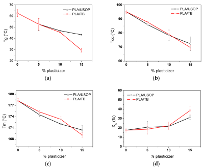

The aforementioned paper covers a range of these plasticizers, such as PEG. Here a problem is that although PEG as a plasticizer additive does promote PLA ductility, PEG tends to migrate out of the polymer. Fortunately there is a dizzying amount of possible plasticizers here, ranging from lactic acid oligomers to epoxidized sunflower oil, as well as linseed, cottonseed, soybean, castor, and other oils.
In a 2025 paper in Polymers by D’Amico et al. the use of used sunflower oil (USOP) as PLA plasticizer is compared with the conventional plasticizer tributyrin (TB). Both show a very similar effect on the plasticity of the final product, though long-term stability of the plasticizer was not tested.
Of course, determining which plasticizer was used in any off-the-shelf spool of PLA filament is effectively impossible. A quick look at a number of commercial PLA filament options, ranging from Prusa to Bambu Lab, shows that their material safety data sheet (MSDS) lists the material only as ‘PLA with additives’.
In a way this makes even ‘regular’ PLA about as much of a mystery filament as so-called ‘PLA+’, with its arbitrary additives such as calcium carbonate.

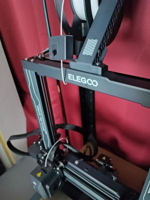

When I recently did some FDM printing for a comparison article series with SLA resin printing, I had dug up a spool of white Sunlu PLA filament that I had left kicking around for probably around three years. This spool had seen itself stuck exposed to room conditions for at least a year when I noticed that after letting it sit fed into the extruder for a number of hours would result in it snapping.
Although I could still print with this filament if I didn’t let it sit too long, it was clear that not only was the PLA rather brittle at this point, it also had assumed a very strong preference for staying in the shape that it was in while on the spool.
What this suggests is thus two things: significant hydrolysis had weakened the filament, and increased crystallization had resulted in both rigidity and brittleness.
Unknown is whether something like a PEG plasticizer was used with this filament, with it having left the building somewhere in the past few years. If the plasticizer is no longer present that would obviously pose somewhat of a conundrum with any attempts to revive the filament.
Ultimately what one can do here is to heat the filament above its Tg for a number of hours, so at least 65 °C for the average PLA blend. This should restore the semi-crystalline state somewhat, although if enough damage has been wreaked by hydrolysis all bets are off. For this particular spool of PLA I did toss it into a Chitu Filapartner filament dryer as it allows you to set the temperature and time, but without a good way to measure the internal material temperature it may not have gotten hot enough.
Considering that this old spool of PLA was fully dried about a year prior in a Sunlu filament dryer using its PLA preset, followed by it being stuffed into a vacuum bag and into an ‘airtight’ container, it’s likely that most of the damage was indeed done by 1-2 years of exposure to room air.
