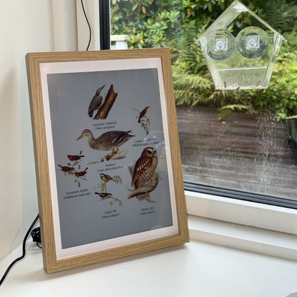

With artificial intelligence being the bête noir of the moment, there are some projects using it which maybe don’t bring much to the table. So it’s nice to see one that uses it in a creative way, and delivers something new. [arnegiacomo]’s e-paper screen is a great example, as it draws a picture in real time of whatever birds are outside.

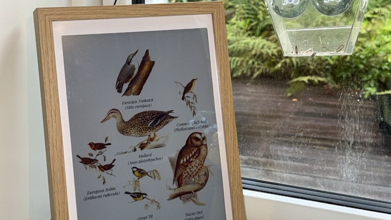

Behind the quite large screen sits a Raspberry Pi 5, and on that is BirdNet-Go, an AI-powered birdsong classifier. A USB microphone catches the birdsong, and Birdnet comes up with the species. The birds on the display are then those species as pictures from 19th century bird spotters guides, assembled into a collage. You can even see what the current set of birds it hears are, live, and they are a representative cross section of the European birds you’d find in Norway where it’s located.
We like this project, both for the bird book vibe it gives, and the creative use of machine classification. Surprisingly this isn’t the first project in this field we have seen over the years.

Hi, [Arne] here. Can confirm my dayjob is coding as a software dev and that I’ve used AI in assisting development in creation of this project. Both Anthropic’s Claude and some different models through OpenCode Go have been used to write code, testing and documentation. Can also confirm that I’ve reviewed all code, but cannot promise that it always “makes sense” – in the sense that code doesn’t always just “make sense”. Code-wise this project is quite simple – most of the work has gone into deciding on hardware, features and most of all sourcing art.
Happy to answer any other questions or critiques :-)

Hi, original creator here. You can of course roast both my code and writing as much as you’d like (feel more than free to) :-) However I’d like to just specify that the project itself runs fully local on a rpi, without any gen-ai. BirdNET is a classification model created by Cornell Lab of Ornithology and runs locally on the pi via BirdNET-Go. The images/illustrations are cut from scans of hand drawn natural history plates – basically old book scans from the 1800s found mostly on wikimedia commons (all artists and sources attributed in the source code).
AI in the form of LLMs has been used as a tool to aid development and writing the source-code, but the core of the project does not rely on it. Happy to answer any other questions you may have about it or my views regarding AI :-)
