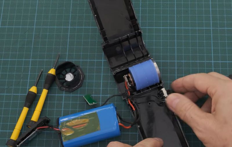

As a certified RC airplane fan, the [RCMakerLab] on YouTube found themselves looking at one of those nifty mini air blowers that provide an alternative to a compressor and canned air for dusting and other high-volume, high-pressure air-related tasks.

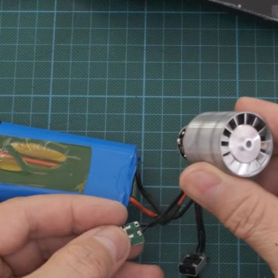

Inside these quite affordable units is a ducted fan (EDF) that can produce fairly high levels of airflow to get to every last dust bunny hiding on a PCB or inside a keyboard, raising the question of whether you could use these to fly a model airplane with.
As can be seen in the torn down unit, there isn’t a lot to these air blowers, with the ESC bolted onto the EDF and only the speed regulator and on/off switch being external controls. This would make it very easy to integrate into an airplane, but leaves the question of whether it can generate enough thrust to make it worth the effort.
Using a custom rig, it was shown to generate up to 110 grams of thrust with a current of 16.5 A, which would at least go a long way to carrying its own battery pack. In order to create an airplane with it, probably two of these motors are needed. There’s also the potential of reducing weight by changing the ESC and such, making reusing these little EDFs from any discarded or broken mini air blowers at least worth a shot.

  2. In aircraft, every gram counts. Using a geared drive to control speed adds a motor and gearbox. It would make more sense to directly control motor speed electronically, eliminating the old speed control, as well.
    1. It is directly controlling motor speed electronically – article mentions the ESC (electronic speed control). Also visible in the video; I didn’t see a gearbox.
      1. The video shows the receiver driving a servo which is geared to the original speed control potentiometer. Adelaide suggests forgoing the servo, plastic frame+gears and potentiometer completely and taking the receiver digital signal directly with a small bit of circuitry (likely would just need a rc low pass filter) to drive the motor’s esc’s analog input. This would save quite a bit of weight.
        1. Presumably just doing stuff because it’s fun before mangling the source configuration, but who knows; ESC is typically looking for PWM signal from some source to determine output motor speed. Presumably could simply clip the potentiometer free and wire directly to the receiver with whatever spare dupont connectors one has lying around, but I’d need to see the ESC to be 100% sure.
