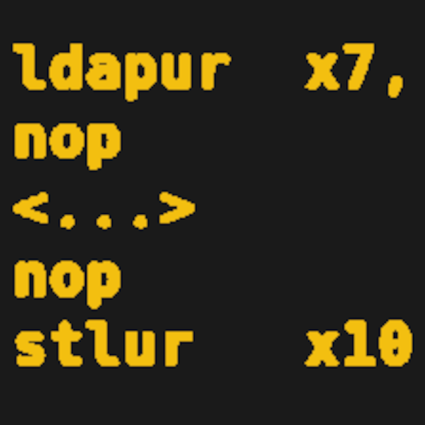

Things get much uglier with unaligned accesses and atomic operations. X86 software routinely performs accesses that ARM would consider badly aligned, and x86 provides surprisingly strong atomicity guarantees within a cache line. FEX sometimes has to catch alignment faults and dynamically patch translated code with barriers. Split-lock operations are worse still: some require excursions through the kernel and signal handlers and can be hundreds or thousands of times slower than the normal case. Qualcomm’s newer Oryon cores improve matters by supporting coherent cache-line atomics, while Valve has shipped a Linux kernel optimization that handles some troublesome unaligned atomics directly.
