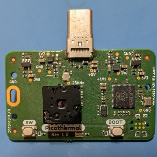

When creating a peripheral for a mobile phone, an obvious path is to create a companion app with which to talk to it. But as we all know today’s app is tomorrow’s non-functional abandonware, so to give his infrared camera a long life, [Cezar Chirila] made it talk WebUSB to a browser instead.
The hardware is conventional enough, a FLIR sensor talking to an RP2040. There’s very little in the way of supporting circuitry save for a power supply regulator, as so much that might be on a standalone project is already present in the USB host device. Running the thing is as simple as going to a landing page in a browser that supports WebUSB, and using the camera. The whole lot is in a GitHub repository, if you’re interested.

Having never worked with a thermal camera before, my first thought was “Why not just make this a UVC device…?” But a single glance at the project page answered that; in hindsight, of course you’d need a lot more controls/tuning parameters than that allows for, the data feed is probably going to be distinct from plain-old video.
