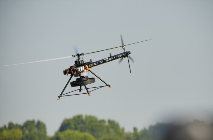

AVIDdrone's winning entry: a helicopter.

We hoped for something revolutionary, something bizarre, something really, really cool — and there were absolutely entries on the field that met all of those superlatives. But sometimes conventional designs are the convention for a reason, and theĀ  winning entry developed by AVIDrone was just a very well made electric helicopter. One big lift rotor, one little tail rotor. Aside from clever details in the solid-state batteries and carbon-fiber construction, it’s a totally normal aircraft — albeit one that can lift 3.84X its dry weight, or 112 lb of payload. Interestingly a battery-powered hexrotor drone took home second place with a 3.64:1 lift ratio. Perhaps the big shock was not seeing combustion engines until third place: another helicopter, this time with a turbine engine. So much for energy density!
