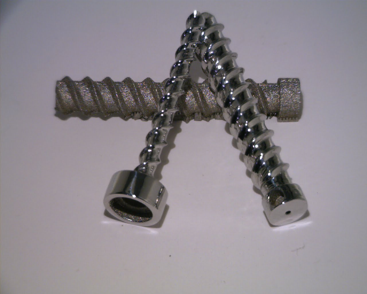

http://3.bp.blogspot.com/_gK7WmTtYN20/S782HwmG4bI/AAAAAAAAABg/uBFXQl51FBo/s1600/0286+-+20100120_060641.bmp
The shell behind the finished part is a “raw” part.
Sadly, waterjet guy is probably correct. Fabbing metal parts like screws, fasteners and threads using print/sinter/whatever technology is amazing in terms of flexibility, but no match whatsoever for proper CNC via a screw machine or similar subtractive process.
You could print a part and them machine it before or after plating, but for most fasteners making more than a few would mean that a screw machine is a better investment. So far, it’s generally a rule that additive process manufacturing is on par with cheap casting.
Other people are correct – you could make a working fastener combo from printing, but it’ll be a bit before they have it down. On the other hand… it’s not really much worse than the lowest priced hardware coming from chinese factories. There are valid applications for this.
