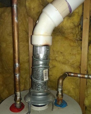

badExhaust
Don’t do this!
The commenters watching these channels are more like hawks than your run-of-the-mill YouTube trolls. Many of them are HVAC techs themselves. These folks are often speaking with the voice of experience. Just as electrical engineers have to deal with bad hardware design, or software engineers deal with tangled legacy code, HVAC techs often have to cope with poorly installed systems, bad service, and years of neglect on heating and cooling systems. Techs have come up with their own vocabulary for the types of problems they run into. The “Run Cap Bandit” is someone who throws a new start/run capacitor on a system with a failing compressor.
