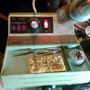

  19. I have had several Weller soldering stations, the cheaper ones and in every case, the screw cap that holds the tip into the barrel eventually, sooner than later, disintegrates and the tip no longer stays in the barrel. Really crappy.
      1. There is a magnet, just not in the tip. The magnet is in the iron and is attracted to the special alloy in the tip and turns on the current. Source: I just took one apart for repair and the tip is not attracted to my screwdriver, but the inner rod that contacts the tip is.
  20. My much loved Weller tcp 45W failed after 23 years. I was out of the room when the switch shorted, damaging the heater. Amazingly i can still use it with a partially shorted heater by running it at a lower voltage from my power supply. That kept me going for a few days until my replacement arrived. I will try Hakko one day but its stiller Weller for me.
    1. The magnastat died on my tcp and went short circuit,an easy workaround was to stick a diode in series in one heater feed!.
    2. just put a diode in series with the heater,i have been using my tcp iron that way for 6 months now like that after the stat died s/c.

  22. My probably 35 year old TCP decided it was time to self destruct and see just how hot it could get.
    The answer, very.
    Very little of the newish tip was left recognisable and I’m lucky it didn’t burn through the workbench.
    It’s been good, but not that good. Tips don’t last long and replacing is difficult with all the different types.
    I can’t bring myself to bin it, but a new far Eastern digital one is on the way.
