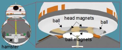

For the head, it seemed obvious that there would be magnets inside the ball, perhaps held in place near the top of the ball by a post extending up from the hamster. Corresponding magnets in attraction would then be attached to the underside of the head, and balls (also mounted under the head) would keep the head moving smoothly over the ball.
The magnet approach for the head has turned out to be the method used by all BB-8 builders that I’ve seen. However, the hamster has turned out to be only one of multiple solutions. Since the original debut many different methods have been used in builds and we’re going to have a lot of fun looking at each separate approach. It’s almost like revealing a magic trick; but really it’s all just clever engineering.

The Hamster Drive
The hamster is typically a two wheeled vehicle that sits inside the ball, not physically attached to the ball in any way. Further support is usually given with casters or free turning balls extending out the front and back to contact the ball and help keep the two-wheeled hamster stable. Moving is done by rotating both wheels in the same direction.
Turning is done by rotating the wheels in opposite directions. This means that each wheel has its own motor. This is called differential drive or tank drive, since it’s how two-tracked tanks turn.
Some have stabilized back and forth wobble by using an IMU to detect the wobble and driving the motors forward and backward in a PID loop. There isn’t a lot of room in the bottom of a hamster for a pendulum type mass that can be swung around for stabilization. However, the more fixed mass as low as possible, the more stable it tends to be.
You can see [Wayne Neumaier]’s hamster drive BB-8 shown in the photo during final testing before painting the ball. He has his two wheels near the bottom.
