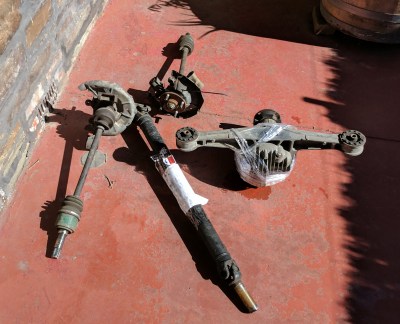

The Torsen LSD from a 1.8 litre MX-5, along with tailshaft & halfshafts with hubs attached. Apparently removing the halfshafts from the hubs is insanely difficult so I’m thankful the wrecker left them attached. Credit: Lewin Day
Now, I initially wasn’t too worried about the swap. The 1.8 litre LSD in itself isn’t a direct swap into a 1.6 litre car. However, if sourced with the tailshaft and halfshafts from a 1.8 litre car as well, everything should just bolt up. Sounds easy, right?
