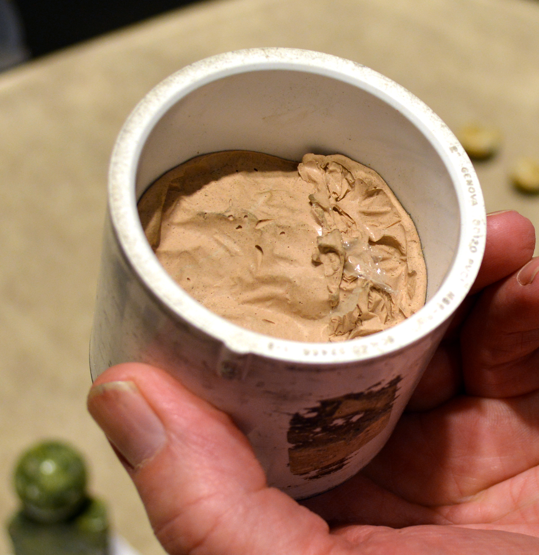

With rough grinding behind him, [Tom] moves on to sanding. He built this custom jig to hold the orb using PVC pipe and body putty (you may know this by the brand name Bondo). He packs it into the PVC, with a ping pong ball used as a mold for the hemispherical pocket.
Sandpaper of various grits is cut first into a circle, then given relief cuts from the outside toward the center so that it will sit flat inside the hemispherical pocket. The marble is placed in the jig and it gets a ride from a sanding wheel with the same grit. [Tom] works his way from coarse to fine, switching to ceramic polishing pads along the way. This gets close, but it won’t be gleaming quite yet.
