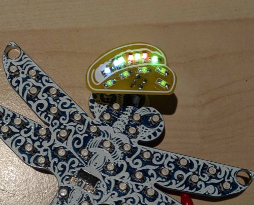

2017’s AND!XOR badge featured a brainslug add-on
The 2017 Saintcon badge contained four spaces for add-ons arranged as two 8-pin headers on a footprint 0.8″ square. Everything to create a functional and interesting add-on was there: the add-on badges had connections for SPI, I2C, as well as 5 Volts and 3.3 Volts.
The results were spectacular: there were more than a handful of unofficial mini-badges that were soldered onto the Saintcon badge, including a very impressive 8×8 LED matrix from [compukidmike]. For the rest of 2017, add-ons were shoehorned into other badges. Last year’s Bender Badge from AND!XOR had a header for an add-on, and there was a fantastic Brain Slug add-on for members of that crew.
