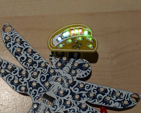

This Year’s Crop of ‘Shitty Add-Ons’
We’re several weeks out from DEF CON, the main badgelife event, and already the art and artistry coming from badge creators is incredible. There will be dozens of different shitty add-ons, each demonstrating the remarkable craftsmanship of the community:
