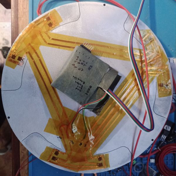

Just about any 3D printer can be satisfying to watch as it works, but delta-style printers are especially hypnotic. There’s just something about the way that three linear motions add up to all kinds of complex shapes; it’s mesmerizing. Deltas aren’t without their problems, though, which led [Bruno Schwander] to undertake a trio of interesting mods on his Anycubic Kossel.
First up was an effort to reduce the mass of the business end of the printer, which can help positional accuracy and repeatability. This started with replacing the stock hot-end with a smaller, lighter MQ Mozzie, but that led to cooling problems that [Bruno] addressed with a ridiculously overpowered brushless hairdryer fan. The fan expects a 0 to 5-VDC signal for the BLDC controller, which meant he had to build an adapter to allow Marlin’s 12-volt PWM signal to control the fan.
Once the beast of a fan was tamed, [Bruno] came up with a clever remote mount for it. A 3D-printed shroud allowed him to mount the fan and adapter to the frame of the printer, with a flexible duct connecting it to the hot-end. The duct is made from lightweight nylon fabric with elastic material sewn into it to keep it from taut as the printhead moves around, looking a bit like an elephant’s trunk.
Finally, to solve his pet peeve of setting up and using the stock Z-probe, [Bruno] turned the entire print bed into a strain-gauge sensor. This took some doing, which the blog post details nicely, but it required building a composite spacer ring for the glass print bed to mount twelve strain gauges that are read by the venerable HX711 amplifier and an Arduino, which sends a signal to Marlin when the head touches the bed. The video below shows it and the remote fan in action.

        2. I did use a fabric tube on a spring initially, but as the Z coord varies quite a bit and I do print tall stuff sometimes, the conduit would bend and kink, restricting airflow. So I went with the elephant trunk, which is still just an intermediary step to be able to print reliably until I completely overhaul the printhead.

      I just did not like the original hotend, I thought it was too bulky and heavy, also I melted the heating block once due to sensor failure (and Marlin getting stuck.. old version) so I figured I might as well change it all.
      I don’t run it that fast now actually, around 150 mm/s. I have run it faster but print quality suffers so I stepped it back. But I still want to see how fast it can be once I optimize the whole print head for maximum lightness. I will probably switch to Klipper at some point and tune it with the accelerometer. My current hardware config would support it, as I run octoprint on an OrangePi one embedded in the printer.
  3. That long bowden tube is why I switched to remote-direct-drive extruders (dual head). But then I designed and built my delta from scratch so I had more freedom than modifiying an existing model. My extruder feed path is about .8″ so I can print the softest of materials even though my print envelope is about 400mm.
    Also, I have tiny custom water-cooled hot ends, with piezo sensors sandwiched between them and the effecter platform so my nozzle tip is the sensor, not the bed. I went through a number of bed-sensing designs but none of them were accurate enough.
