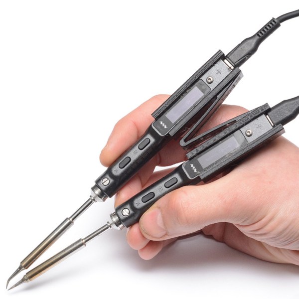

It started when [Mitxela] was faced with about a hundred incorrectly-placed 0603 parts. Given that he already owned two TS101 soldering irons, a 3D printer, and knows how to use FreeCAD (he had just finished designing a custom TS101 holder) it didn’t take long to create cost-effective DIY soldering tweezers.
Two screws allow adjusting the irons to ensure the tips line up perfectly.
The result works great! The TS101 irons are a friction-fit and the hinge (designed using the that-looks-about-right method) worked out just fine on the first try. Considering two TS101 irons are still cheaper than any soldering tweezer he could find, and one can simply undock the TS101s as needed, we call this a solid win.
One feature we really like is being able to precisely adjust the depth of each iron relative to each other, so that the tips can be made to line up perfectly. A small screw and nut at the bottom end of each holder takes care of that. It’s a small but very thoughtful design feature.
Want to give it a try? The FreeCAD design file (and .stl model) is available from [Mitxela]’s project page. Just head to the bottom to find the links.
We’ve seen DIY soldering tweezers using USB soldering irons from eBay but the TS101 has a form factor that seems like a particularly good fit.

      1. The C210 has a thermocouple near the tip which allows good temperature regulation. But by only checking the heater resistance the HT140 is not taking advantage of this. The heater is much larger so it doesn’t really react to the tip cooling down when you are trying to solder something, and with the small thermal capacity of C210 tips you need to run it very hot to compensate.
        I don’t really know why they haven’t just used the thermocouple. But at least my unit only has two wires to the tip connectors.
        1. Because they arent using resistance? You only need two wires to measure thermocouple on Hakko/JBC cartridges because heater is in series with thermocouple.
