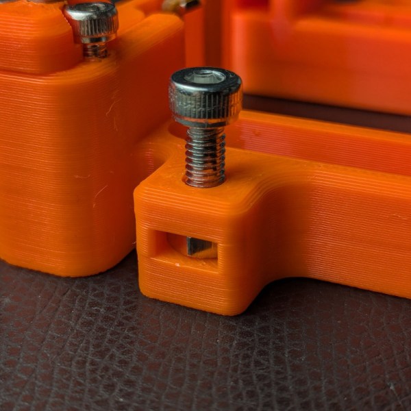

If you’ve been designing parts for 3D printing, you probably have some tricks and standards for your designs. [Rahix] decided to write out a well-thought-out set of design rules for FDM prints, and we can all benefit.
One of the things we liked about the list is that it’s written in a way that explains everything. Every so often, there’s a box with a summarized rule for that topic. At the end, there’s a list of all the rules. The rules are also in categories, including part strength, tolerance, optimization, integration, machine elements, appearance, and vase mode.
For example, section two deals with tolerance and finish. So, rule R2.8 says, “Do not use circular holes for interference fits. Use hexagon or square holes instead.”
We also appreciate that [Rahix] touched on some of the counter-intuitive aspects of designing for FDM printing. For example, you might think adding voids in your part will reduce the filament and time required to print it, but in many cases it can have the opposite effect.
Some of these — maybe even most of these — won’t surprise you, but you still might take away a tidbit or two. But having it all down in a checklist and then the ability to scroll up and find the rationale for the rule is great.
Do you have any rules you’d add? Or change? Let us know. Meanwhile, we were eyeing our favorites about adding machine elements to prints.

  1. the excerpted diagram for threaded parts is a frustrating example of a bad mentality to have when 3d printing.
    the difference in tensile strength between vertical and horizontal printing is almost nothing compared to the dramatic unsuitability of most 3d printed plastics for static tension, full stop. if it’s holding tension, both are insufficient and it doesn’t matter whether one is 20% stronger by not carrying stress through layer adhesion. if you’re so close to “is plastic strong enough for this” that the difference in printing orientation matters then you should be using a metal bolt duh.
    but if you’re going to 3d print threads, the factor that will encourage the horizontal orientation is your printer’s overhang behavior. threads-as-overhangs is asking for a different kind of problem than a truncated cylinder-as-overhang.
    it seems to me like they’re obscuring the real substantive unavoidable difference between printing orientations by meditating on some strength difference that is almost irrelevant

        i’ve read a ton of ‘data sheets’, where they will tell you that the tensile strength of plastic across layer adhesion is 0 and the tensile strength within a layer is 20% or 300% more than that and it’s up to the engineer to determine if 1.20 times 0 or 4.00 times 0 is bigger than their tensile load.
        i’ve also read a bunch of ‘application notes’ or ‘best practices’, where they ought to tell you straight up “don’t use plastic for tensile loads.” and in such a document, they would tell you not to print threads vertically even if there’s no tensile load, because the overhang will deform them.

      2. the difference between plastic and metal in this function is something like 1000 to 1. the difference in printing orientation is much less than 2 to 1.

      2. you’re imagining a world where you print it vertically, it fails, and then you print it horizontally and it succeeds because 20% or 300% more strength is sufficient.
        but, as others have pointed out, 1.200 = 4.000 = 0. tensile loading plastic is not going to work in any orientation.
        BUT the true fact is, if you print it vertically, your threads will be garfed from overhang deformation. the whole tensile strength meditation is a distraction even if you truly do have a featherweight loading

      1. Plastic creep is measurable down to 5% of the UTS in common plastics. What that tells you is, your plastic parts will creep and ultimately will not hold tension, so engineering a plastic screw that should hold appreciable sustained force is really an exercise in futility.
        It is a real issue in engineering with plastics, and one that should not be ignored, yet is commonly ignored by engineers because the exact information is not readily available. This leads to a ton of bad designs that eventually fail.
