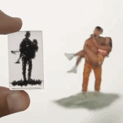

Gaussian splats are a 3D scanning technique aimed at replicating a visual rather than geometry, like the mesh-based 3D-scanning we usually see on Hackaday. Using photogrammetry, a point cloud is generated with an associated 3D Gaussian function describing the colour at that point. Blend these together, and you can get some very impressive photorealistic 3D environments. Of course, printing a Gaussian smear of colour isn’t trivial, which is where the hacking comes in.
14-face isospheres do a good job of replicating the complicated Gaussian, as seen with this experimental long-exposure shot.
[Wyatt] first generates the Gaussian splats with an app called Polycam, which outputs inscrutable binary .ply files. With AI assistance of dubious quality, [Wyatt] first created a python script to decompile this data into an ASCII file, which is then fed into a Rhino script to create geometry for printing. Rather than try and replicate the Gaussian splat at each point perfectly, which would melt his PC, [Wyatt] uses 14-face isospheres to approximate the 3D Gaussian functions. These then get further postprocessing to create a printable mesh.
Printing this isn’t going to be easy for most of us, because [Wyatt] is using a multi-color DLP resin printer. The main body is clear resin, and black or white resin used for the space defined by the isospheres created from the Gaussian Splat. When the interior color is white, the effect is quite similar to those acrylic cubes you sometimes see, where a laser has etched bubbles into their depths, which makes us wonder if that might be a more accessible way to use this technique.

  1. And he didn’t notice that his idea of Gaussian splats is wrong? They are not the Gaussian distribution curve rotated around the x axis, which looks like an onion. He has to take that function, give it the distance from the center of the splat as parameter, and will receive the density of the blob at that distance. It’s more like the electron orbitals you learn about in chemistry.
    1. Yeah, that shape is really weird. What you’re looking for is a fuzzy sphere, where the density falls off as a Gaussian in any direction.
      (Or heck, I bet you could approximate it any sort of other way that would work well for your situation, or the math, depending on which you’re aiming for.)
        1. Love pedantry! And precision! So wait — you’re all exactly the kind of people whose input i actually want for the next iteration of this project — what 3D shape would you choose to represent a gaussian? – Wyatt, the guy in the video
    2. I think this fellow is an artist, so I think it’s to his credit to recognize that the “Gaussian” in “Gaussian” splat related to the normal distribution. That said, the solution he stumbled upon– an ellipsoidal isosphere– did a good job of erasing his misconceptions.
      1. Hi Tyler! Thank you for writing this, and resonating with my project! Genuinely curious what mesh shape you’d make a ‘gaussian’ — the reason i initially chose that onion-shaped thing was that i’m printing it in semi-transparent material, which means that opacity is modulated according to thickness, meaning that the pointy bits turn almost transparent. Like a digital gaussian. Thoughts?
    3. THAT makes sense. Thank you! The only question is… what would that function look like if you HAD to constrain a mesh around it? I think it might look like an onion? – Wyatt, the guy in the video

    1. That is not a DLP resin printer, that is a Stratasys Polyjet printer. They use piezoelectric printheads to jet resin onto the deck and, cure it with a UV lamp on the same carriage. I am not sure what model but I know the J8/J7 series can do full color and multi material printing.
      1. Thank you! I spent too long trying to figure out how on earth he could do multi-color like this with DLP. That makes far more sense.
