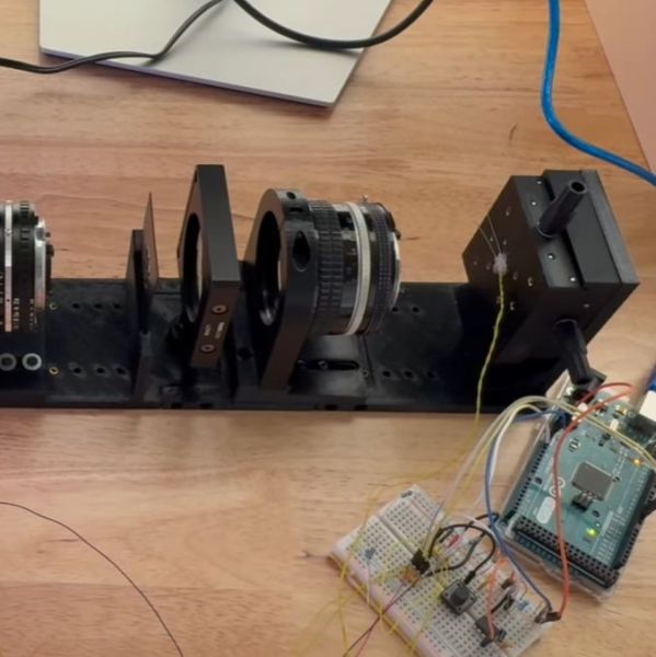

There’s a strange allure to single-pixel cameras due to the simultaneous simplicity and yet fascinating features that they can offer, such as no set resolution limit. That said, the typical implementations that use some kind of scanning (MEMS) mirror or similar approach suffer from various issues even when you’re photographing a perfectly stationary and static scene due to their complex mechanical nature. Yet there’s a way around this, involving a LED matrix and a single photoresistor, as covered by [Jon Bumstead] in an article with accompanying video.
As he points out, this isn’t a new concept, with research papers cited that go back many years. At the core lies the signal processing technique called compressed sensing, which is incidentally also used with computed tomography (CT) and magnetic resonance imaging (MRI) scanners. Compressed sensing enables the reconstruction of a signal from a series of samples, by using existing knowledge of the signal.
In the case of this single-pixel camera, the known information is the illumination, which is a Hadamard matrix pattern displayed on the 64 x 64 pixel LED matrix, ergo 4,096 possible patterns. A total of 4,096 samples are thus recorded, which are subsequently processed with a Matlab script. As pointed out, even 50% of the maximum possible matrices can suffice here, with appropriately chosen patterns.
While not an incredibly fast method, it is fully solid-state, can be adapted to use other wavelengths, and with some tweaking of the used components probably could cut down the sampling time required.

    The LED matrix certainly uses PWM and there’s probably also some delay while the driving signal scans all the LEDs through the matrix. You can clearly see artifacts at 5’22 and 5’33 for example (while there’s probably also the camera’s rolling shutter involved). So i wonder if PWM + scanning delay could interfere with the measurements involved here and lower the reconstruction result quality?
    1. Thanks! you are definitely right about the measurement errors. I had to slow down acquisition, primarily because the synchronization between the pi and arduino wasn’t great. Of course, the photoresistor was slow too.
  5. Did not see the slow response time of photo resistors mentioned in the video or comments above. Just so [Jon Bumstead] and people trying this are aware, the response time for a photo resistor (AKA light-dependent resistor (LDR), photo conductive cell or Cadmium Sulfide (CdS) cell) can be as long as one second (https://en.wikipedia.org/wiki/Photoresistor). This burned me back in a college project years ago. And I’ve never forgotten it. Photo diodes do not suffer from this problem.
    [Jon Bumstead] has a scope, so it would be easy for him to test the rise and fall response time of the photo resistor he uses. Still, it might be interesting to test if the resolution improves for slower scan times and degrades for faster scan times.
    1. That is horrifically slow. Photodiode and their common transimpedence amplifiers aren’t light speed, but compared to >100ms they may as well be
      1. What’s your definition of “light speed”? Even the cheap and ponderously slow jellybean BPW34 photodiode has a risetime of less than 10 nanoseconds, about the time it takes for light to traverse a small room. Photodiodes built for speed (like for fiber communications) are a thousand times faster and are still cheap.
        Running this compressed-sensing rig at the speed a fast photodiode will permit (microseconds instead of minutes) will run into photon starvation issues: simple the counting statistics. That said, yes, there is ample opportunity for speed increases here, even with the LDR sensor.
