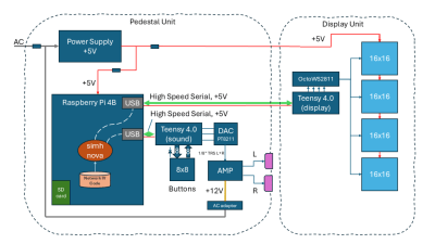

For the re-creation, the neon lamps were replaced with 16×16 WS2811 LED modules, driven via a Teensy 4.0 using the OctoWS2811 library. The display Teensy is controlled from a Raspberry Pi 4, hooked up as a virtual serial device over USB. A second Teensy (you can’t have too many Teensies!) is responsible for scanning a miniature 8×8 push button array as well as running a simulation of the original sound synthesis setup. Audio is pushed out of the Teensy using a PT8211 I2S audio DAC, before driving a final audio power amp.
Attempting to reproduce accurately how the original code worked would be tricky, if downright impossible, but fear not, as the network-iv-rebooted is running the original code. Since the artist was astute enough to keep not only the engineering drawings and schematics, but also the original paper tape of the Nova 1210 program, it could be successfully run using the SIMH Nova emulator. The simulator needed to be modified to support the optional ‘device 76’ GPIO device added to the Nova 1210 for handling the extra connectivity. This was a small price to pay compared to the alternative. That said, most of the heavy lifting on the I/O side is performed by the pair of Teensies, with modern coding methods making life a lot easier.
