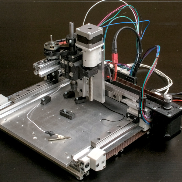

The advent of cheap and accessible one-off PCB production has been one of the pivotal moments for electronic experimenters during the last couple of decades. Perhaps a few still etch their own boards, but many hobbiest were happy to put away their ferric chloride. There’s another way to make PCBs, though, which is to mill them. [Tom Nixon] has made a small CNC mill for that purpose, and it’s rather beautiful.
In operation it’s a conventional XYZ mechanism, with a belt drive for the X and Y and a lead screw for the Z axis. The frame is made from aluminium extrusion, and the incidental parts such as the belt tensioners are 3D printed. The write-up is very comprehensive, and takes the reader through all the stages of construction. The brains of the outfit is a Creality 3D printer controller, but he acknowledges that it’s not the best for the job.
It’s certainly not the first PCB router we’ve seen, but it may be one of the nicer ones. If you make a PCB this way, you might like to give it professional-looking solder mask with a laser.

  1. This is a worse solution than a $250 3 axis router.
    Belt drive x and y bad.
    Most of the z-axis is there, but useless unless you’re skeletonizing the bed.
    Linear rails then moved from one end?
    The main reason this is a bad idea…single use tool.
    Better to build a board holding fixture for cheap router.
    At least x and y screws.

    1. I can think of at least 2 reasons to do it:
      It’s quicker than ordering from China, so iteration is much faster
      Because building a machine like this is satisfying and fun
      You know the old mantra – If it ain’t broke, fix it anyway. Because you can.

    3. Agree a ~£150 CNC could do this, but if you do a lot of boards, having a single-purpose machine optimised for PCBs could be worthwhile. Also smaller, which is an important constraint for many of us.
      And maybe you’ve got a nice big (but lower accuracy) CNC, so you don’t need a small CNC, you just need something to do PCBs.
      1. Big CNCs generally have great accuracy and expensive nicely concentric spindles.
        They have ball screws on x and y. This thing has belts apparently repurposed from a zero contact laser cutter. Spindle could be 3d printed housing around skateboard bearings, hard to say.
        The only explanation is:
        ‘He wanted to make something from parts he had laying about. Didn’t care about actually making PCBs.’
        Fair enough.
        Good reason.
        Bet he now knows why most such machines are bed slingers.
        Bet he also wants more Z, to get a second use from it.
        Has seen how cheap screws are, said ‘doh’.
        His next version will look a lot like a $250 dollar chinesium CNC router (Not the $150 version, he apparently likes Al).
        If that spindle is tuneable, then good design.
        Throw a dial indicator on chucked up cutter and show us the wiggle.
        I’ve seen the outside of outrunner used as pully trick before, in the RC world.
        Pick the right motor and RPM is not the issue, offset drive bad idea unless making spindle adjustable.
        At that scale, grind the output shaft of the motor true and work from that w precision ground collars.

    I also do not see this as a “Single use tool” as HaHa suggest. Sure, I would never build this machine exactly as it’s presented, but the build is certainly good enough to extend to a 3D printer and a PnP machine.
    I would love to see some video’s of this thing running. As others have written here, I also have some doubts about the belt drive, but as PCB milling is usually done with very fine mills, (0.3mm or so for isolation routing, up to around 2mm for the PCB outline) cutting forces are also low. For the rest this machine has enough rigidity so that the axis will move quite linearly without mush sag. He also wrote he choose 400steps/rev stepper motors to increase stiffness (i.e not for the resolution!). This really makes me curious how this machine holds up in use.
    The XY stage of this is nearly perfect for a 3D printer or PnP. This asks for having the base plate removable so a higher Z-axis can be added without sacrificing milling rigidity. It also looks like the work envelope is relatively small for the size of the machine. With a few small changes the work envelope can be extended to nearly the size of the working table. But complexity also goes up rapidly with such changes…
    Stiffness can also be improved by using a bit bigger timing belts. You can buy Pulley systems with a 1:3 ratio that use quite wide HTD3M (or similar) belts for the “Linear part” and a thinner belt for the gearing loop. These are sold as standard parts and used in (bigger) laser cutters. Both the extra gearing and the thicker and wider belts improve stiffness.

    2. The article addresses all these points. It’s not “better” than any of these solutions in general, but is ideal for my usage. Cheap off-the-shelf routers are much bigger and often don’t work well enough (mostly very poor quality spindles and questionable motion systems).
      I still order boards, but being able to make some things myself can save weeks of waiting in the prototyping phase.
    3. Thanks for the thoughtful comment.
      You’re right that the build area is small relative to the machine, but there really are not many areas where it could be improved without making it bigger, except for cutting a notch into the carriage plate to get about 20mm of X travel.
      I’m also interested in improving the stiffness, but I’m not sure about wider belts. I don’t think that’s the limiting factor (10mm GT2 belts are used on much larger machines like the MPCNC), but that’s something that can be measured when I get around to it.
      Since writing the article I’ve used it to mill a few aluminium parts, and it works well enough, so it’s not a high priority.

  5. I love cunning the timing belt inside-out as a plain belt and using the outside of an out runner BLDC as the large pulley for the spindle. That’s prime “get-it-done” lankiness, a perfect hack.
    1. Yes indeed, I also already mentioned that. Flat belts are out of fashion but still a nice solution for high speed / low force applications.
      The modern equivalent would be a Multi-V belt. And this is actually a quite nice innovation. These belts combine the extra clamping force of a V-belt for the small pulley, while on the big pulley they can run on a flat surface. I.e., if a (symmetric) belt slips, it always does so on the small pulley (because the included angle is smaller). So the Multi-V reduces slippage where it counts, and combines that with the cost saving of a flat surface for the big pulley. These belts are very common in washing machines, and are also used for dynamo’s in cars.
    1. I did spent a while thinking about this, but didn’t come up with any interesting avenues to explore. I know others have too.
      It feels like one of those problems which just doesn’t have a clever solution. Brass rivets do seem to work well enough (the ESP32 board shown has a handful of them), and this is even the method recommended by commercial implementations of this process, who have the motivation and resources to invent something better.
      It seems like it would be tedious, but the speed of the whole process really limits the overall complexity of boards you would make with it, so a typical design will only have tens of vias, which is quite manageable.
      1. I don’t think rivets and special design compromises will work for much more than one offs. If someone could solve vias then it could really open up boutique manufacturing of small batch electronics at home. Fiber laser for making boards including solder mask straight to a pick and place machine then solder oven then stick it into an enclosure that you could also plausibly drill with a cnc and etch front panel markings on with a laser. I suppose one sided boards would already open up something like guitar pedals, but most things beyond that require vias to be a solved problem.
