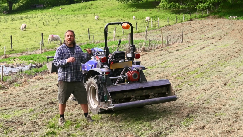

Ever since wealthy European landowners started displaying vast, unused swaths of turfgrass as status symbols, regular folk have been chasing that perfectly mown and tended lawn for similar reasons. In the modern era, most mowers used to maintain these spaces use a spinning blade attached to a motor of some sort, but this can be dangerous especially on rocky fields like [Greenhill Forge] needs to mow. For these fields it’s best to use a different type of mower, and he’s built one from scratch.
This type of mower is called a flail mower, which has hinged, sharpened hammers attached to a central rotating drum. Since the flails have less rotational speed at the ends, they are less dangerous if they strike solid objects like rocks. To build one, he first builds the central drum and flails, then the enclosure to mount it to his tractor, and then a drivetrain to attach it to the tractor’s PTO. Since everything is getting built in [Greenhill Forge]’s metalworking shop, many of the parts needed to be fabricated from scratch, which involved several jigs for the plasma cutter as well as forging some steel to make some of the thicker parts.
Although not many of us have fully-stocked metalworking shops like this, it shows that almost anything can be built with the right tools. A forge is actually fairly accessible for those looking to start smithing; we’ve seen them built from little more than an off-the-shelf unmodified microwave or from a propane torch and some cookware.

  5. I own both cutting systems, including tractor mounted slasher, and large RC controlled versions of both, go with the flail. It could still kill you but it will be less messy. It really pays to be paranoid when using such gear because it will fail on you, it is just a matter of time, so know where the projectile spray field is and never enter it when the machine is operating, even when idling. The fail “hammers” can shatter too, the commercial ones are more like short thick serrated blades, they are uniformly hard so when you hit anything resilient enough the sharpnel will cut through anything, even sheet metal if not thick enough.

  6. I’ve had a 8′ John Deere flail mower for about 25 years. Works great for field mowing (ie keeping the grass shortish and keeping brush from growing in the field). Not sure why someone would DIY this.
